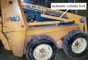

Interesting stuff, guys! Is adding a dual pilot operated check valve between the valve and cylinders a good solution to loader drift? Is the dual pilot operated check valve the same thing as the "cross port checks" that you refer to? One scenario for which I would like to have zero drift is when using the loader as a scaffold support.
Some better quality loader valves have mechanical opened checks built into them. These stop or significantly reduce cylinder drift caused by spool leakage as long as the load is trying to retract the cylinder.
If the checks are hydraulically piloted the ywill cause the FEL to chatter or bounce while being lowered under load. Reason is that to open you must build pressure in the rod side of the cylinder. The P.O. check opens the load drops and pressure is lost in the rod end so the check closes until pressure builds, check reopens, FEL drops, check closes, etc.
FYI: To meet safety codes for handling personal the load holding device must be hard plumbed or mounted to the lift cylinder.
