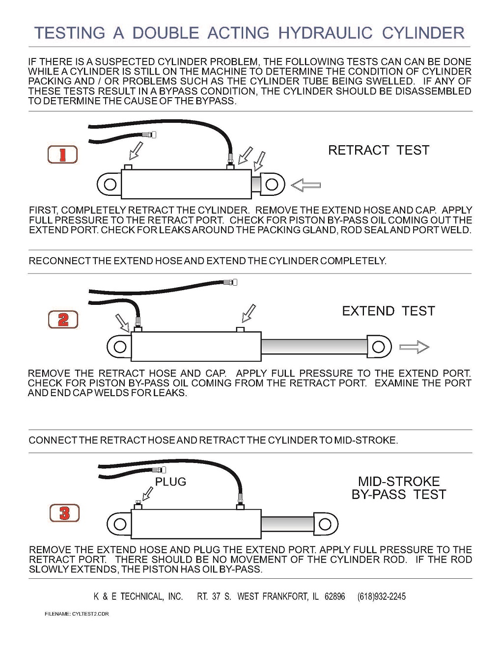

Hello, I am attempting to probably rebuild the lift and curl cylinders on my Ford 7108 Loader. After viewing a few U Tube vids I had never thought that the leak down (thats slowly gotten worse over the years) could be the control valve . So I found this video of how this woman checks for it.
Anyways I just checked mine this way.
Raised the arms up and supported them. Then removed the quick disconnects. (for the lift cylinders). And then removed the support. It lowered pretty quickly. So I assume it has to be the seals in the cylinders ,as the control is no longer connected to it.
Is this how its normally done?
   / Cylinder Leak Down test? #2
Yes, that's how it's done. It usually is the seals vs the valve.
Here is another way to do it, but it's really overkill.
