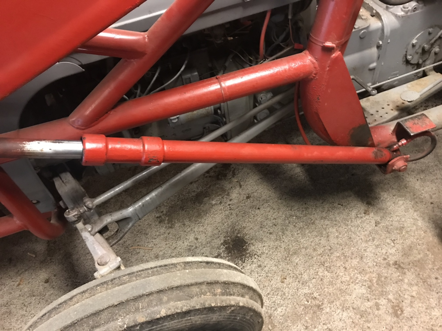

Looking for a packing kit for loader cylinders on a 1953 Ferguson to30 with superior loader. Anybody have part numbers or link? Going to pull them apart to clean them up and get them to stop leaking.

Best bet is to pull it apart and go to your local hydraulic shop to match up the seals.
Do your best to clean up the rust on the rod, if it’s pitted or rough it’ll just tear up the new seals.
