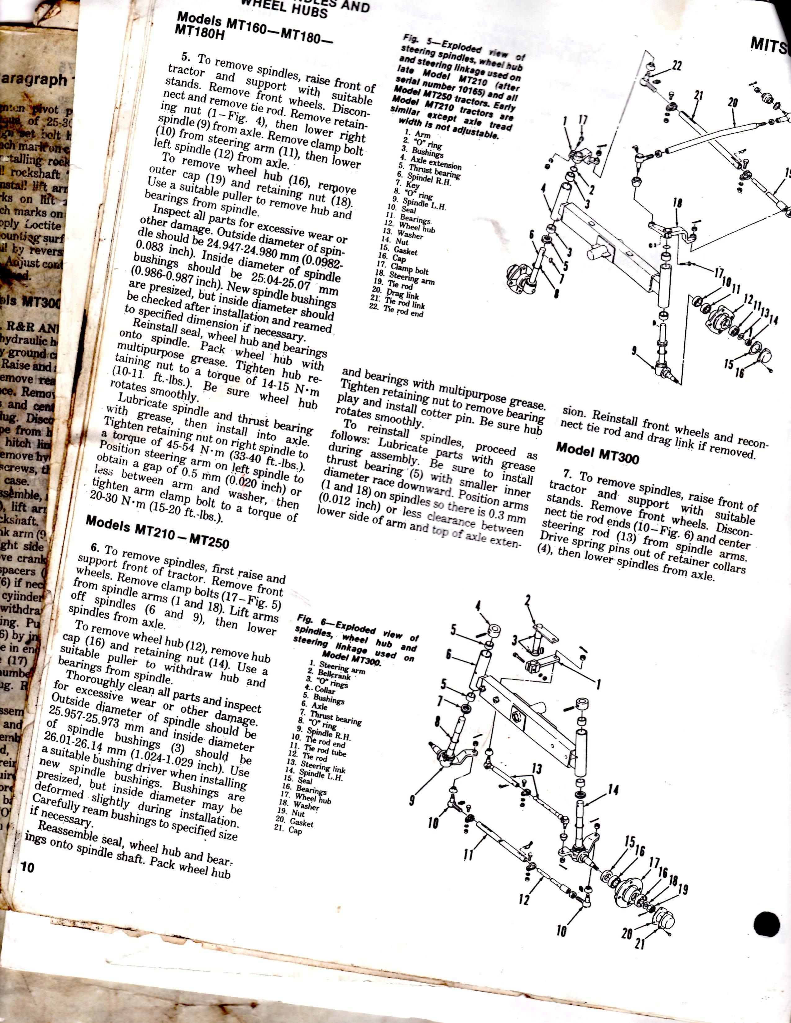

So I just noticed that my front wheel bearings on my Mitsubishi D2350 are out. Lots of slack. The job seems pretty straight forward....take the tire off, pull off the dust cover...the bearings and seal should come right out...unless someone knows something I don't before I start breaking everything down. Thanks

You have it right. Here is a diagram from my I&T 180-300 models ( pretty well covers your model). I am assuming from your description that it is a 2WD model ( not a 2350D)

Awesome thank you so much. Seems pretty basic. Finally got my cooling system in order. Probably going to fix a couple of oil leaks now and do the bearings. I guess when it comes to an almost thirty year old neglected tractor I'm in for monthly repairs.
