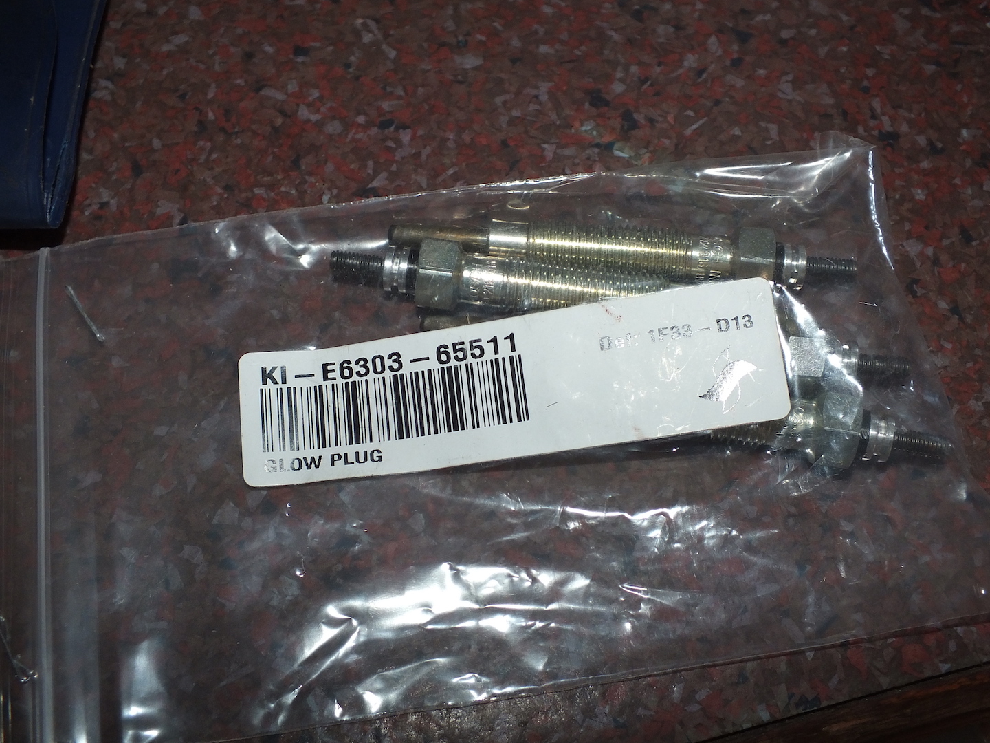

Over the last few weeks I had noticed a gradual worsening in cold starts, with lots of smoke at start up persisting for a few seconds coupled with rough running. The engine would smooth out after several seconds with the smoke disappearing completely. With our weather slowly cooling off here in Tas (a few frosty mornings already), the problem was only going to get worse. Anyway, I had the opportunity to test the glow plugs with a multimeter. I tested them while still in the engine, with the busbar (the rail that connects all of the plugs together electrically) removed. The factory workshop manual states 0.8 ohms resistance value for the plugs. All but one returned satisfactory results. The offending glow plug showed an open circuit (presumably a broken coil inside). I was tempted to replace only the defective glow plug, but knowing that one had failed the others wouldn't be far behind. After all, they were all installed at the same time at the factory, and that was 950 hours ago. I also checked to make sure that the main power lead that powers the glow plugs was delivering full voltage, which also allowed me to see if the relay timer was working properly (I counted 15 sec total time). After ordering a full new set of plugs from a local dealer (at $60AU a piece - ouch
), I proceeded to tackle the job.

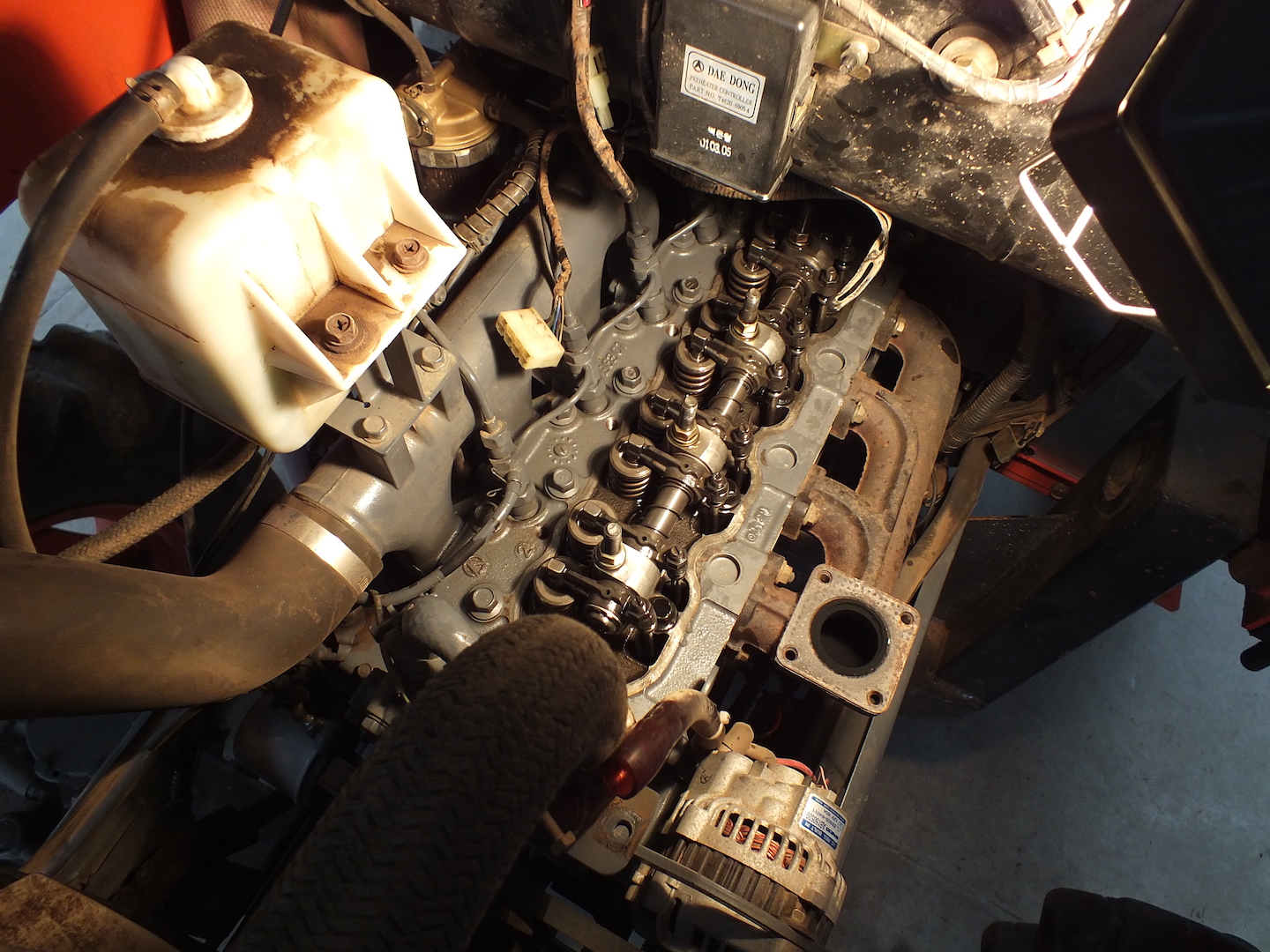

Adjusting the valve clearances of course requires rotating the engine manually, and since the glow plugs were already out it was an ideal time to check the clearances. The engine was easy to turn over by simply pulling on the fan and belt simultaneously (being careful not to put too much gorilla force on the plastic fan blades
). I had to remove the muffler for better access and to later completely remove the valve cover. The four nuts securing the muffler came out easily after a quick spray with CRC and the valve cover nuts were easy to undo as well. The valve cover itself, however, needed careful separation from the cylinder head by the use of a thin scraper blade to 'break' the seal. Once the cover and seal had been removed, I inspected the seal, which looked to be in serviceable condition (still pliable and 'soft'). So I didn't bother buying a new one, instead giving it a careful clean up with cloth.

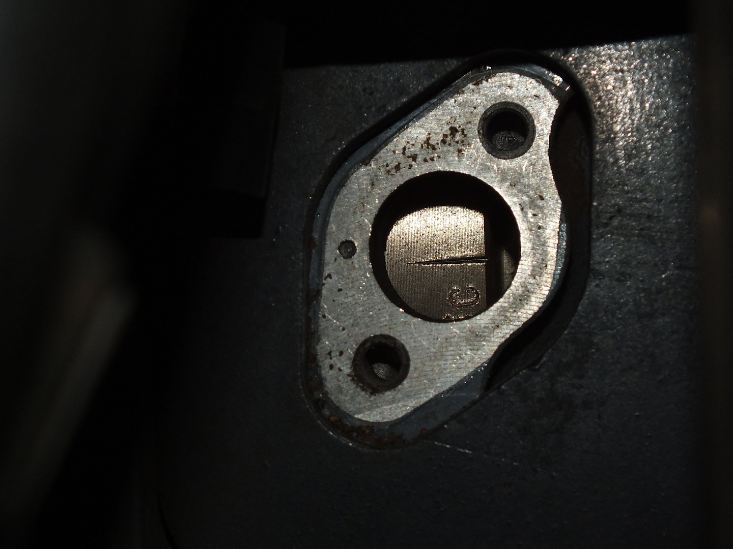

Now, it took me a while to find the location of the timing marks. The workshop manual states that the marks are on the flywheel, but makes no reference to the location of the inspection 'window' (obviously at the rear of the engine but where exactly?). Eventually I found a little cover fasted by two bolts on the right side of the tractor (accelerator pedal side). The little cover has a cork gasket behind it, which can be damaged easily. After prying it off carefully, I found that I was only a couple of degrees off TDC compression stroke on No1 cylinder. I had already roughly located TDC compression stroke on No1 cylinder by rotating the engine clockwise (when view from the engine pulley) and waiting for the No4 cylinder valves to 'rock', meaning that the intake valve is just opening while the exhaust valve is just closing (if that makes sense :confused2: ). Anyway, once the timing marks were aligned I proceeded to check the valve clearances. Note that the engine must be stone cold for this procedure.

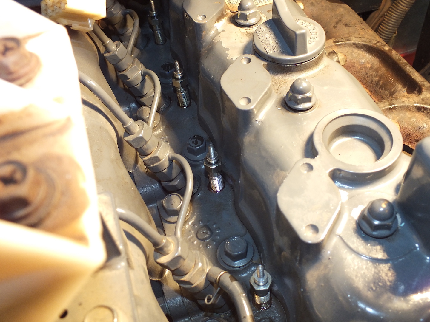

With No1 cylinder on TDC compression, I measured the the clearances on:
Intake and exhaust on No1 cylinder
Intake on No2 cylinder
Exhaust on No3 cylinder
They were all on the loose side, but only just. After adjusting the above valves, I rotated the engine exactly one full turn clockwise (when viewed from the engine pulley). With the timing marks aligned again, I measured the clearances on:
Exhaust on No2 cylinder
Intake on No3 cylinder
Intake and exhaust on No4 cylinder

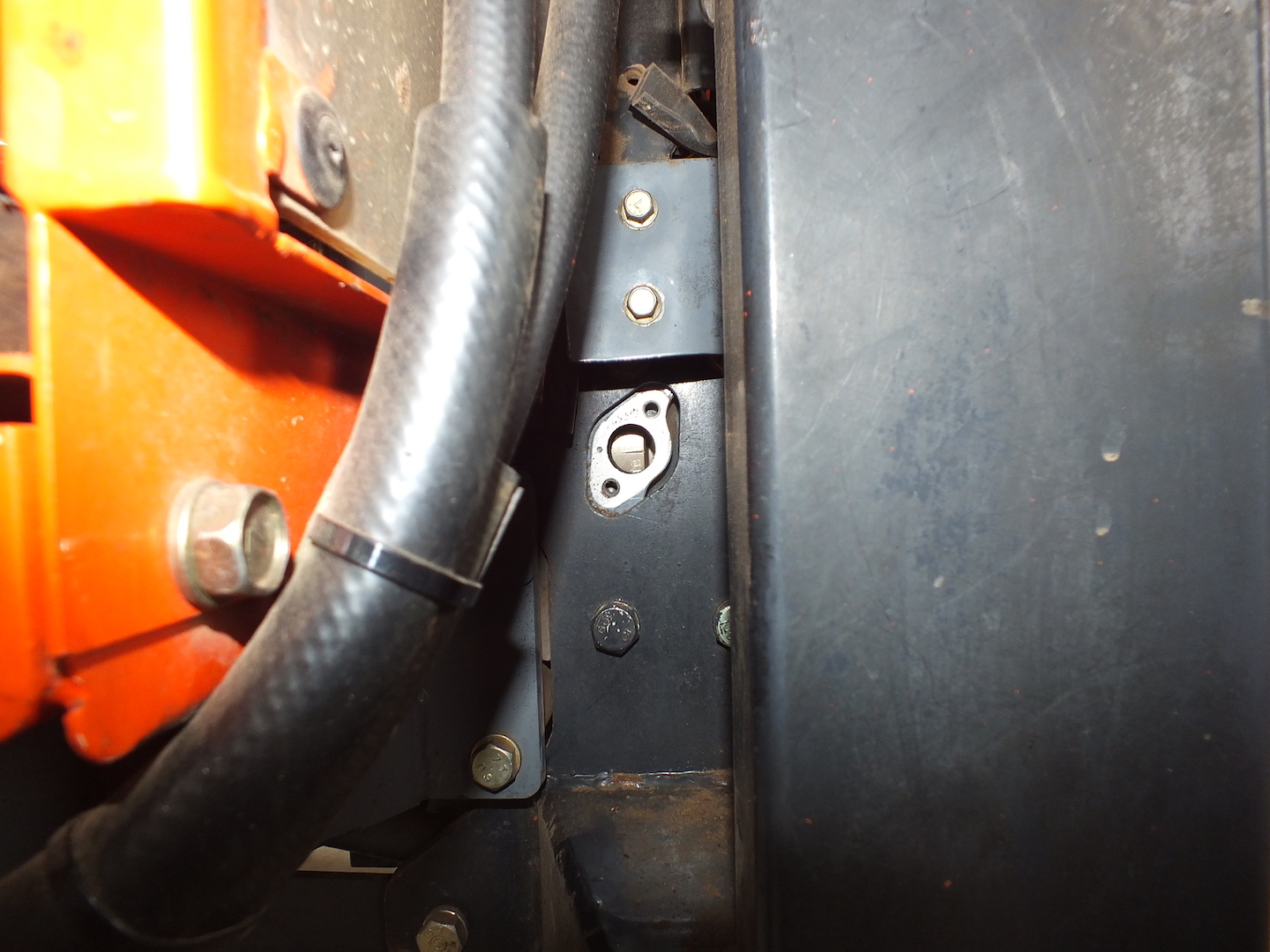

Again they were a tad on the loose side, so I adjusted them to spec. After checking to make sure all of the adjusting locking nuts were tight and that no feeler gauges or any other tools were left inside the engine, I cleaned the sealing surface on the cylinder head and reinstalled the valve cover, tightening the nuts progressively starting from the centre of the cover out to the ends. With the muffler back in, I lubed the threads of the new glow plugs with a small amount of anti-seize (cast iron cylinder head with steel glow plugs so hopefully no risk of electrolysis) and nipped them up firmly (but not too tight). With all of the other bits and pieces bolted back in it was time to kick the engine in the guts. On my DK45 the glow plug indicator on the dash lights up for 8 seconds, but I wait (listen) for the relay to click off (another 7 seconds) before cranking the engine. The difference in that cold start was well worth the time and money. The engine started instantly with only a quick small puff of smoke and not to mention it ran smoothly. It really did put a smile on my dial

Pic 1: new glow plugs
Pic 2: view of the valve train (muffler removed)
Pic 3: Timing mark inspection window
Pic 4: Close-up of timing marks aligned
Pic 5: New plugs installed
