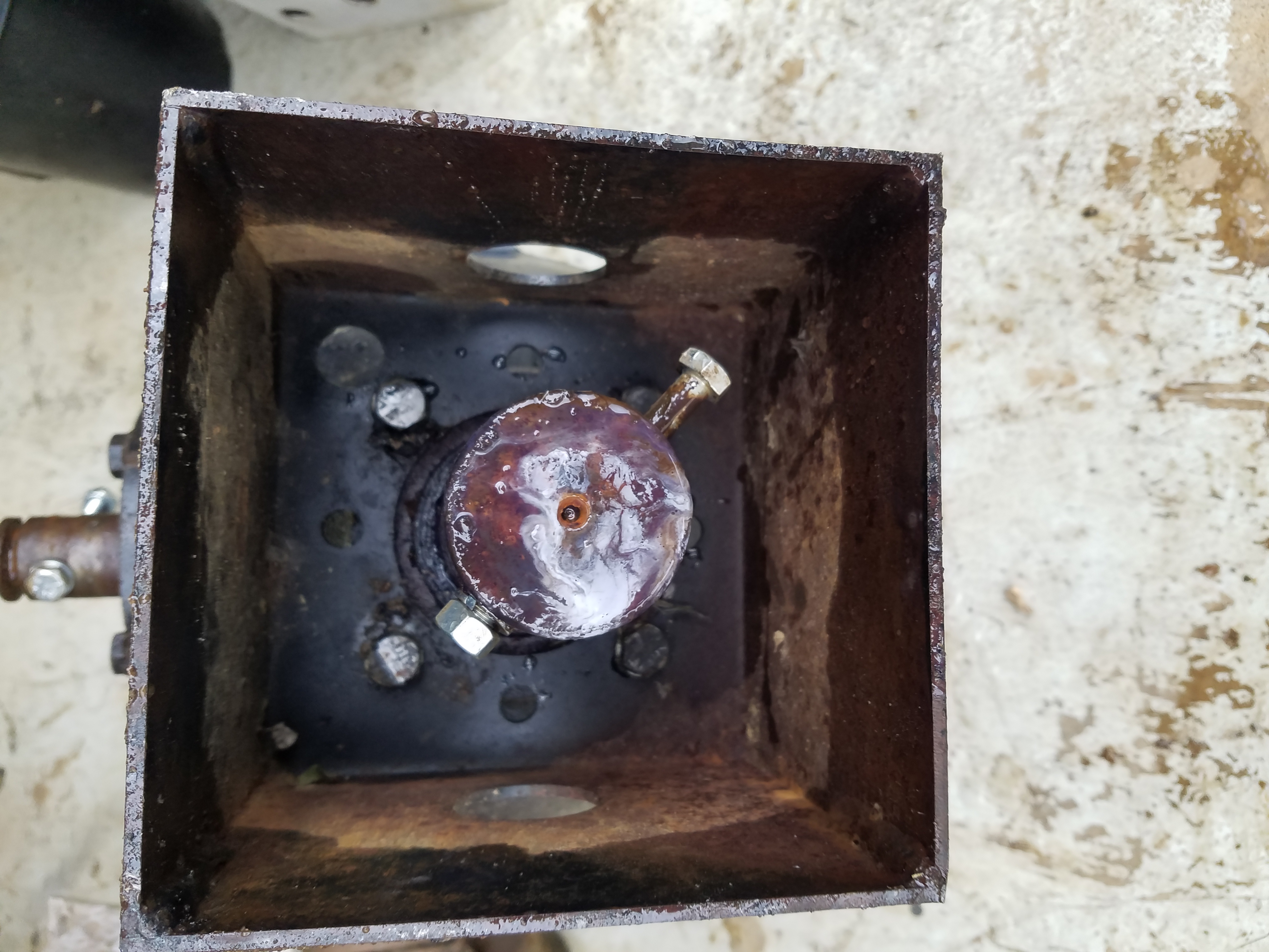

It has been sitting up for a while (outside) and I did retorque the bolts but it still leaks. Anyone know where I can go to get replacement gaskets, seals and bearings for the gearbox?
   / Dale Phillips Post Hole Digger leaking bad #2

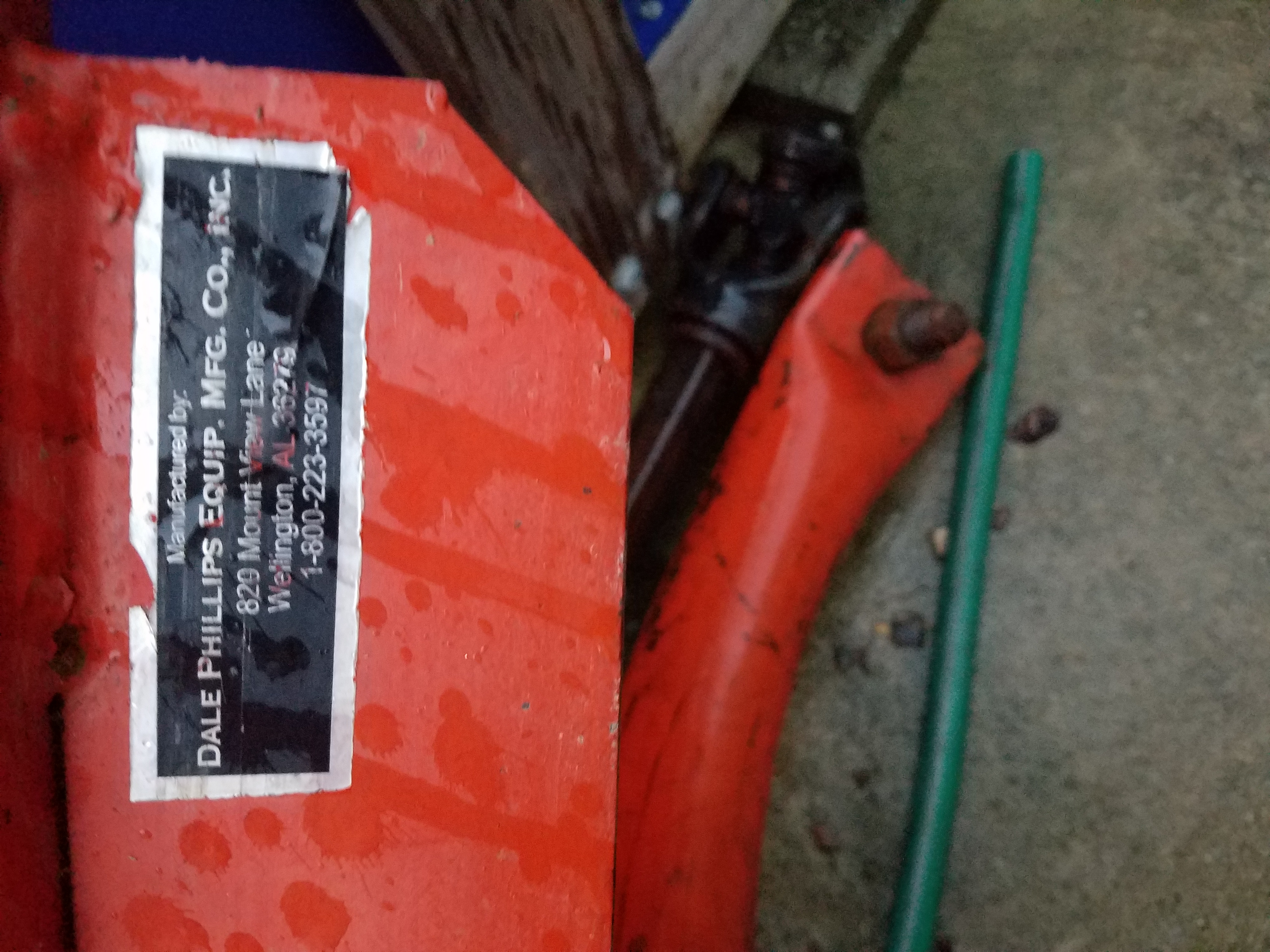

Can you post some good pics of your PHD pumpkin ? Might be a Comer , Omni etc brand and perhaps we can steer you in the rite direction .
Heres the old address of the old DP facelity but dont think there still in business Address: 820 Mt View Ln, Wellington, AL 36279
Phone: (256) 892-3597

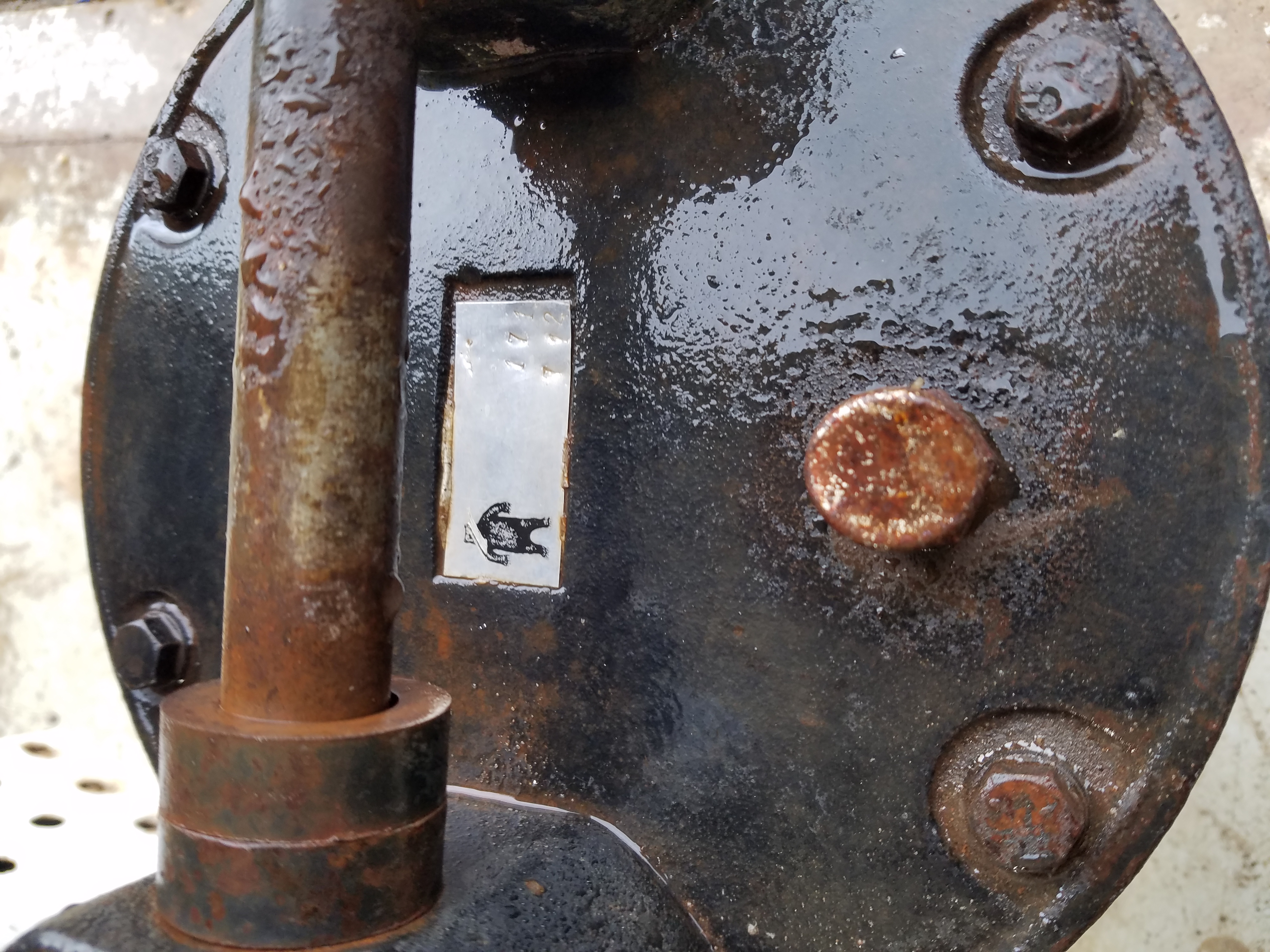

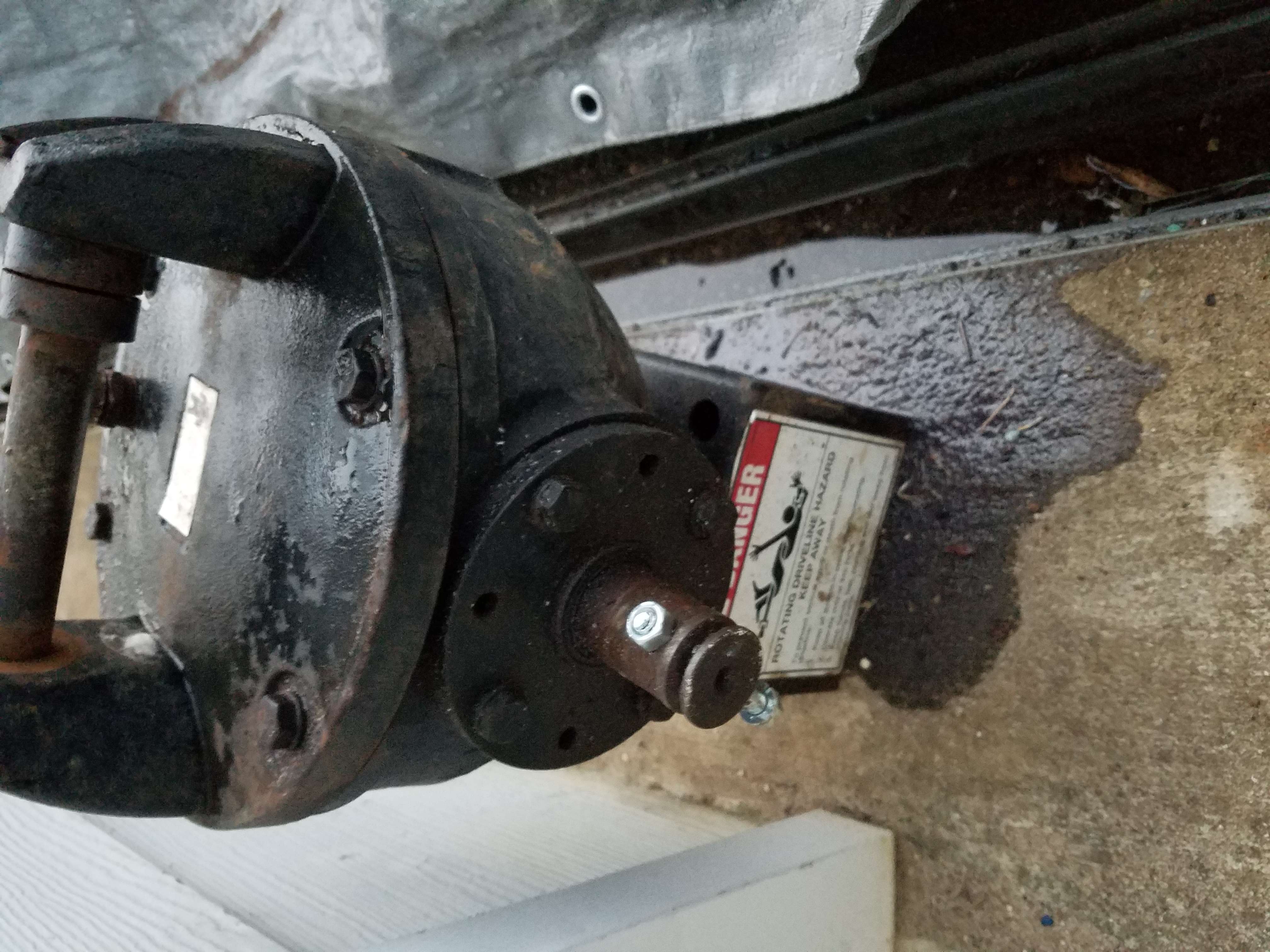

Here are the pictures I have. I may have to use some cornhead grease in the meantime.

Why not just fill it with cornhead grease and forget it? would last a long time, maybe more.
Over the years I have filled the leaky old brush cutters with cornhead grease and never another problem.
   / Dale Phillips Post Hole Digger leaking bad #5
Allrite Dennis I'am no expert but that box to me does not look like a Comer or Omni . It might be a ITG send pics and return info to Jeff at jcampbell@dnequipment.com
make sure explain everything you need , send good pic's and name , phone number , email so he can get back at you .....
Here is there website @ DN Equipment - DN Equipment

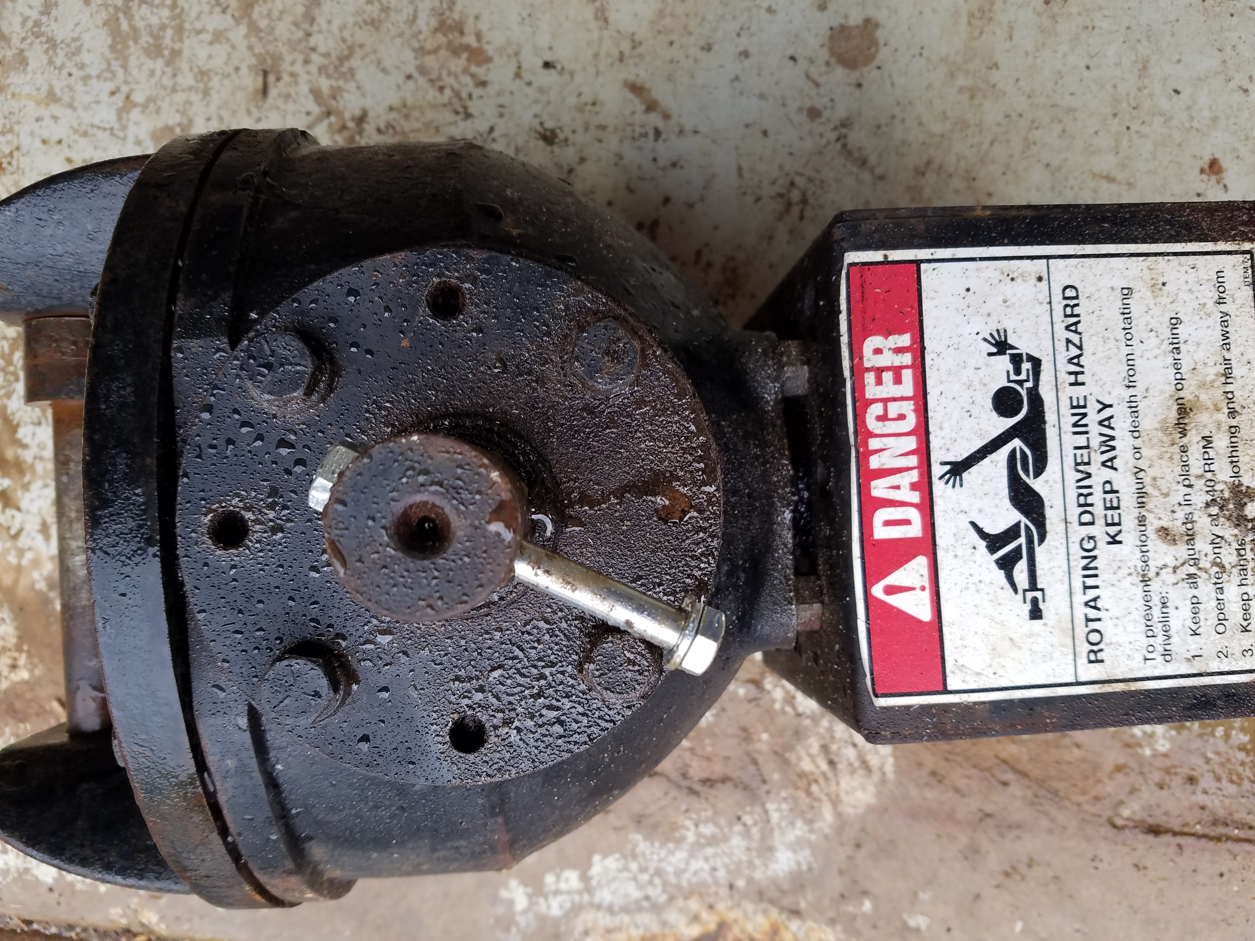

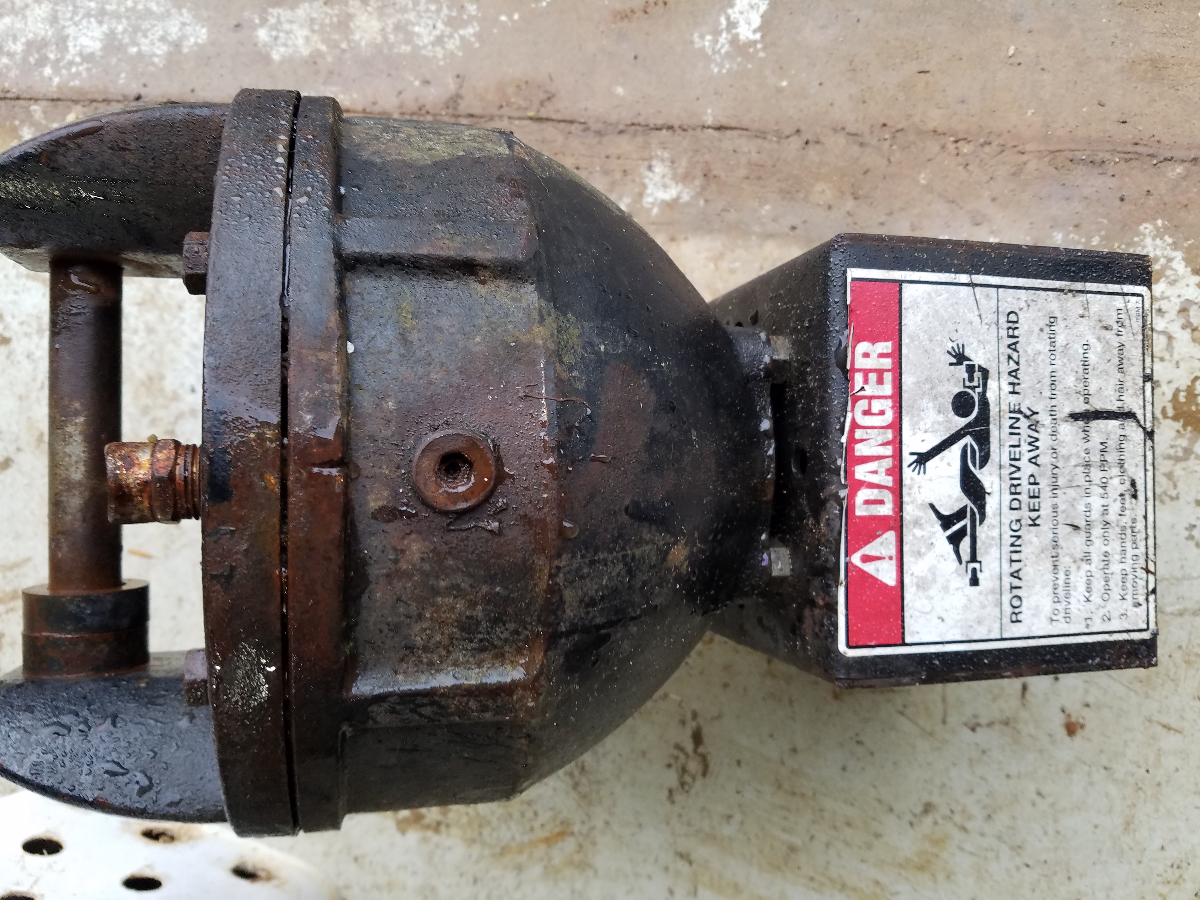

Thank you very much bullbreaker. Here are some more pictures. Had some phone in meetings all morning.

Agrisupply sells those 'Grizzly' branded gearboxes. They list an output seal as well as the whole box.
