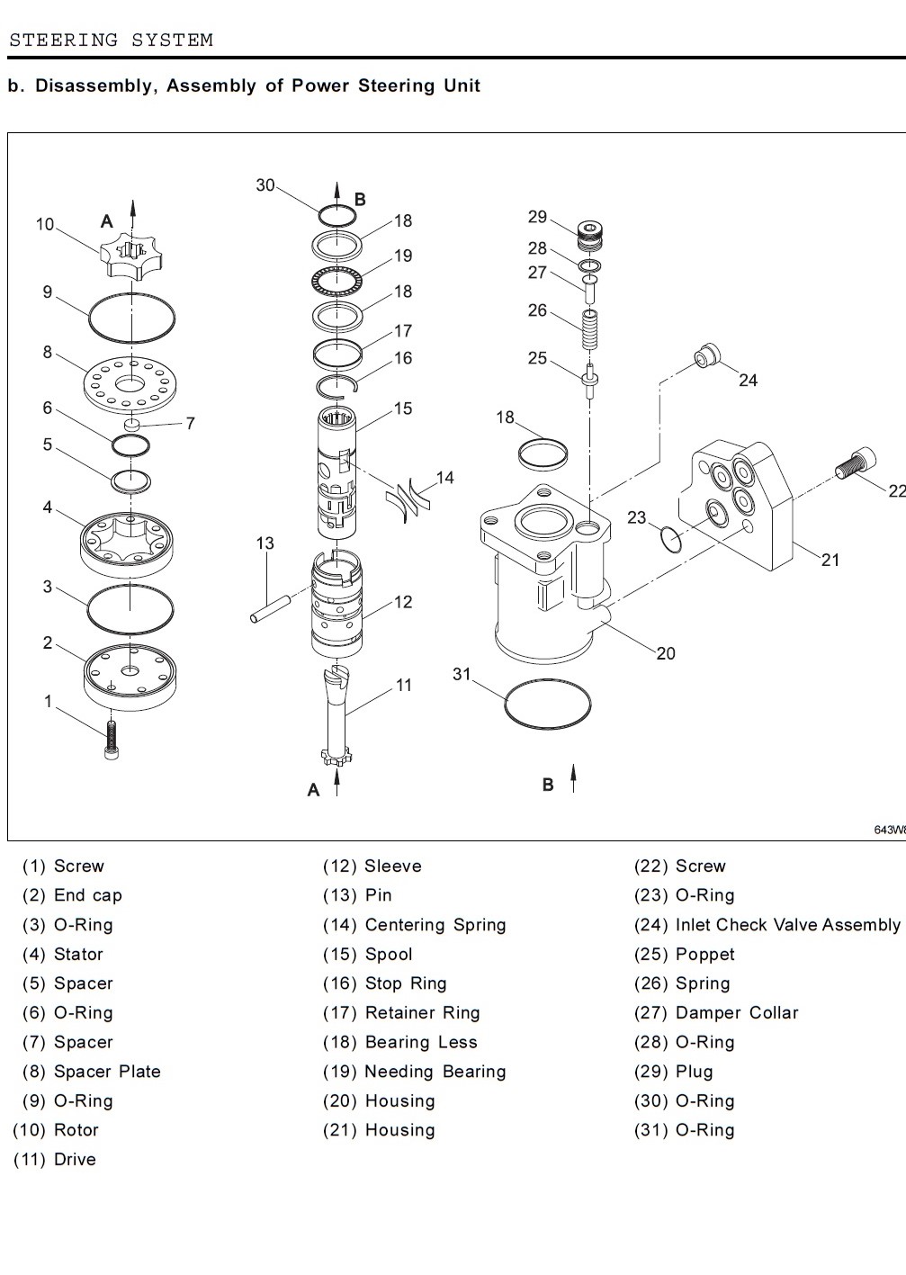

I was getting ready to put up the tractor yesterday and noticed something liquid on the floorboards of the tractor.. "I sure hope that is water".. I wasn't:eek::eek:
It was hydraulic fluid. I took off the covers under the steering wheel, and found fluid pouring out around the steering shaft seal on the hydraulic power steering unit. Not good. I was hoping for a loose hose fitting or busted hose.. No such luck. I called the dealer and they got it and took it with them sometime this morning. I guess time will tell what the damages will be. I know that steering unit is not cheap. And the free pickup and delivery period has passed too. It was for one year.

James: Bad news is that the steering unit is like $500 and the Kioti parts site doesn't show any of the internal parts. On the positive side, some of the service manuals (like the CK35 manual) show an exploded diagram of this item and it looks like there are common, replaceable seals and O-rings at the top end where the shaft goes in. So maybe a local shop (or DIY) can seal it for reasonable money.

I stopped looking at the DK manual too soon. The DK35 Manual does show dis-assembly of this unit, which is great if you can find parts.

Likely popped an o-ring on the spool.

$354.17. The majority was labor and transport. With a replaced O ring and some replacement fluid. They said getting the unit out was time consuming. It looked like several steps in the manual. Considering transport and labor I am satisfied with the price. I should get it back Monday. I guess bad things happen to good tractors.:)
