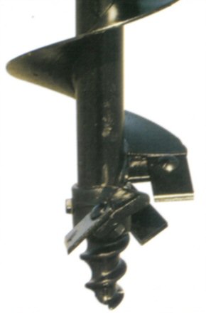

A post hole digger is pretty much a post hole digger. You let the clutch out and it spins an auger. Lower the three point and it digs a hole. Regardless of brand they all pretty much work this way. Augers make a huge difference. I think these days augers are pretty much interchangeable between brands. I have a Bush Hog post hole digger and their augers have "Bear Claw" teeth. These are staggered like chain saw teeth. These augers are far better than any I have used before.
