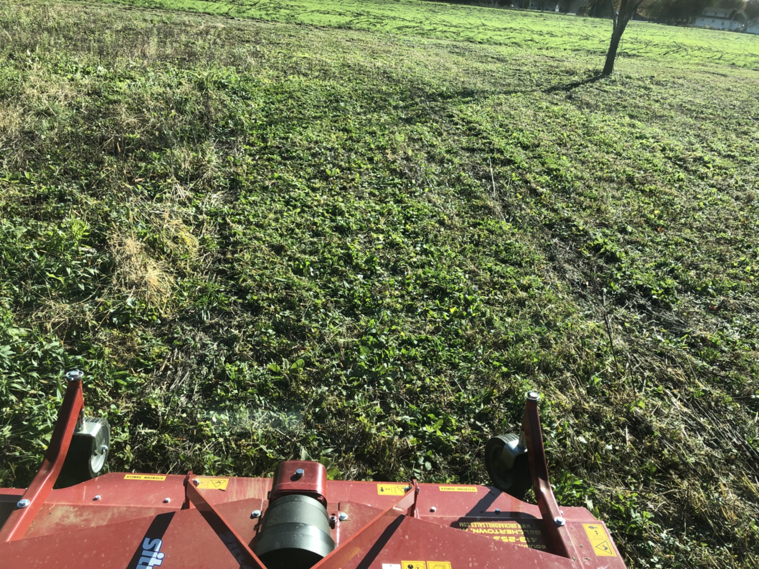

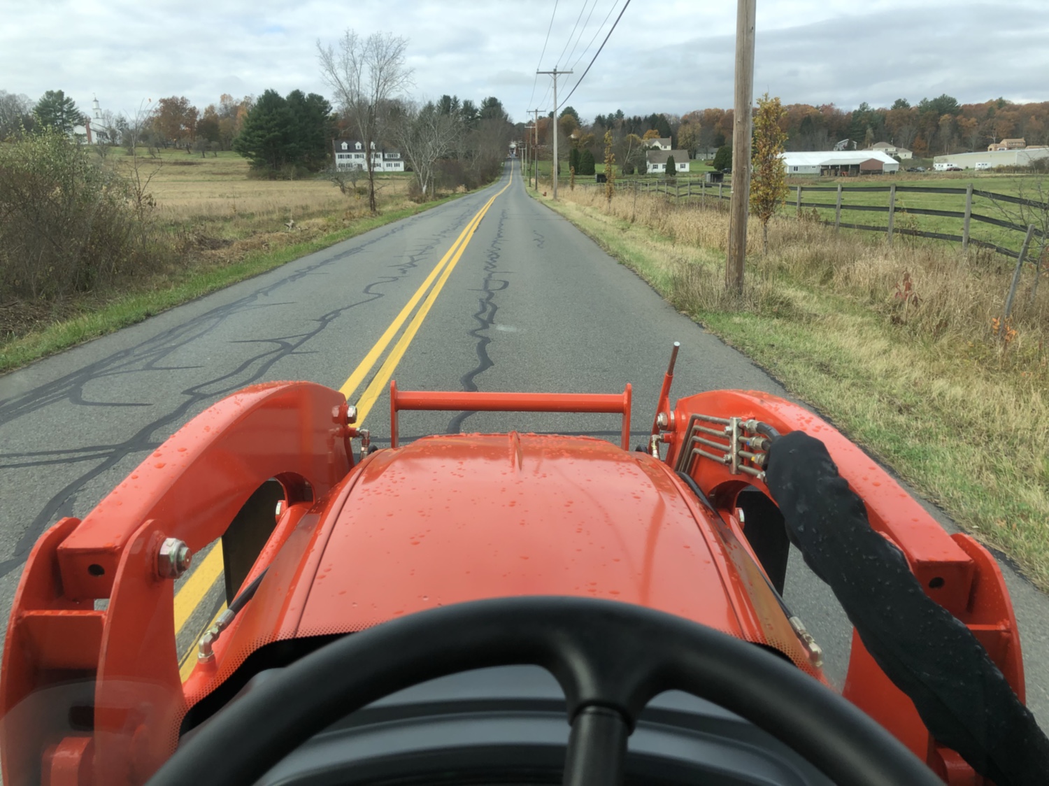

I️ picked up my new CK3510SE HC this morning with 72” Sitrex Finish Mower and loader. I️ was loving the heated cab for the 15 mile drive back to some of our land early this morning with temps just below freezing outside. Was definitely warm enough inside I️ took my jacket off after a mile or two.

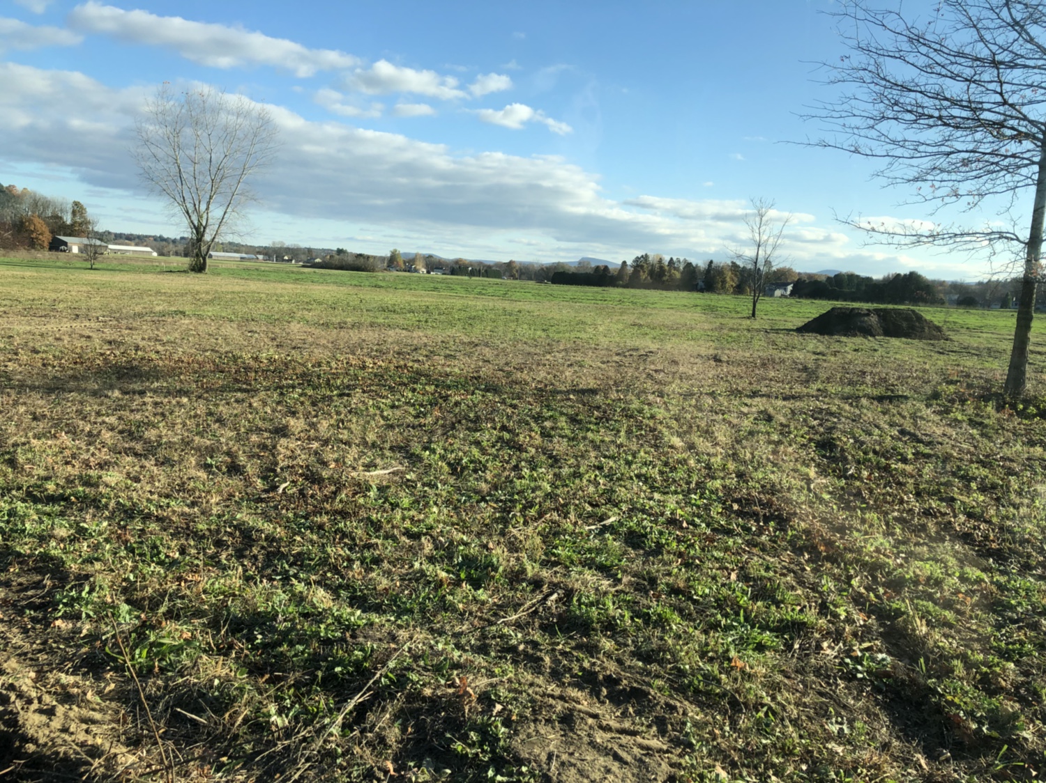

Tractor had 1.7 hours on it when I️ picked it up and I️ put 6.5 hours on it mowing, doing some loader work spreading 3 dump trucks of top soil and driving another 9 Miles back home. Tractor worked wonderfully and the Sitrex mower did a fantastic job even in some brush that it probably shouldn’t have been in....
