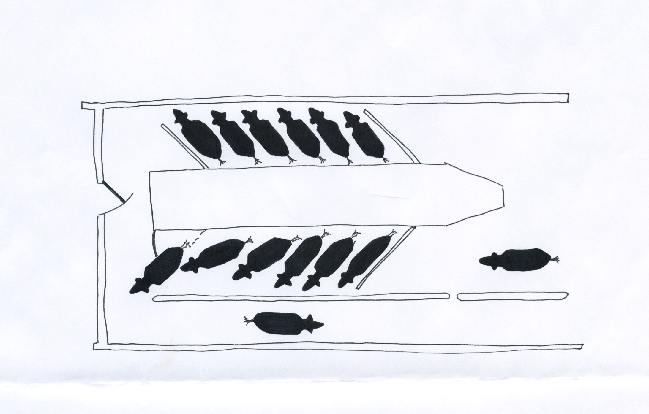

It depends on how much snow I have lying on the ground. First few snow falls never had a problem just back blading it to the side of the drive going forward. Once the banks get 2 feet high, I either have to run in reverse and blade it off farther, or herringbone it off using the FEL & bucket. I'm a wimp and prefer to do my plowing only once per storm, so I usually wait until it's over before clearing. Got one storm that was so deep and heavy that I had no choice; I couldn't blade it and had to herringbone my way down the entire drive.

What is herringbone? I've never heard that term before.

This is a barn, but it could be your driveway. :)
The center is the driveway. Each cow is a loader push, making a herringbone pattern.
