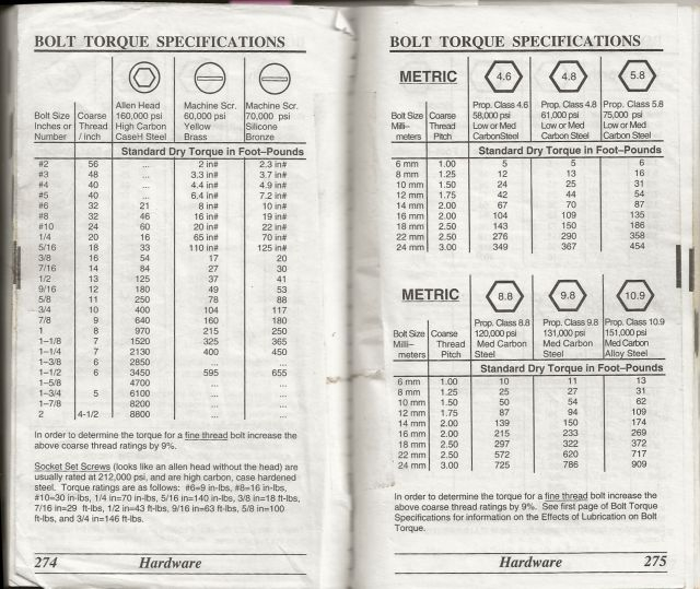

Reading through the owners manual of my new tractor (Kioti CK2610 HST, if it matters) I came across a couple of "torque tightening charts", one for metric, the other for ISO...the charts list "bolt sizes" and "grades"-- along with the minimum and maximum torque for each...
Other than the required torque on the wheel lugs, there is no other torque specs in the manual... I looked online for a service or repair manual and came up short...
I went to a website (BOLTDEPOT.COM) and came across a subheading--"BOLT HEAD/WRENCH SIZE"--which lists, for example, a "10mm bolt" which requires a "14mm" wrench... I could then assume the 14mm bolt head on my tractor would correlate to an M10 bolt... find the M10 torque specs in the manual and go from there... (I'm sure the whole process would take much less time to actually perform and it would take to read and understand my methodology...;))
This seems like a rather convoluted method of coming up with the correct torque wrench settings for the various fasteners I'm checking, but if it works... what the heck, eh?
I'm thinking I'll double-check the fasteners before going full in... I.e. back out one of the bolts and measure the shank diameter, then compare this with the bolt head/shank size listed on the "BOLT HEAD/WRENCH SIZE" chart... (reading the bolt grade on the bolt head is a no-brainer)...
Does this method make sense?
   / Deciphering bolt torque requirements #2
Any quality bolt will have "type" stamped/embosses on bolt head... Wrench size doesn't determine what quality/torque requirements for bolts.....
THis has always been my go to documentation for reference to bolting and other things around the property.......
Pocket Ref by Thomas J. Glover (2010, Trade Paperback) for sale online | eBay
Example of pages...
And you can use a METRIC or SAE wrench to check bolt diameter, for instance a 10mm open end wrench slipped onto shank of bolt "snugly" will indicate bolt is probably 10mm, if wrench will not go on, the bolt shank is bigger, if it fits on sloppy loose the bolt shank is smaller.... Wrench is sort of fixed width calipers....

Do you mean does your method make sense or does theirs?
Your method makes sense to me if you are asking if you are interpreting a bolt/head torque chart correctly. But do you really want to fly that close to the sun?
I can see that their simple bolt chart makes sense for a basic operator's manual, requires no extra input from engineering, and provides a clamping pressure that works most of the time as long as the bolts are always bolting the same materials together. So it's a plus from manufacturing viewpoint. And good enough for an your operator's manual - which is where you say it comes from. I'd bet their shop manual is more specific.
The purpose of a torque spec is a subject for endless debates. When should it spec for clamping pressure & when for maximum safe stress on the bolt?
It's never simple. If it's safe bolt stress choice , then the assemption is that bolting an aluminum head to a cast iron block with a head gasket sandwiched in there has the same clamping requirement as a wheel and axle. Pretty clearly that's not always true.
But before we second guess them, we ought to give Kioti the benefit of double checking....
Go to their SHOP MANUAL, look into the repair sections - and see if their description of procedures for cylinder head torque or varioius hydraulic pump bodys includes special bolt torques for those components. I'm betting that they so.
