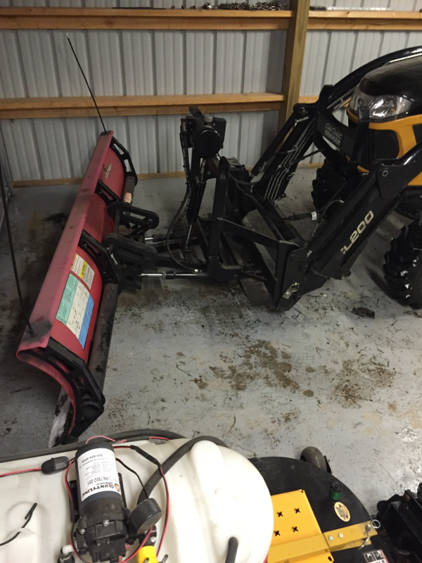

Are you mounting on a front hitch or onto the loader arms? Please post some pictures of your setup when done.

It is on the loader arms. My dealer welded a quick mount onto the plow for me. Now I can easily switch and put on the bucket if I need to move snow around. Here are a couple pics I found I already had. I wired it so I use the original hand held remote that came with the plow. If the plow was a foot shorter it would be perfect but I can't complain because the plow was basically free. Sent from my iPhone using TractorByNet
