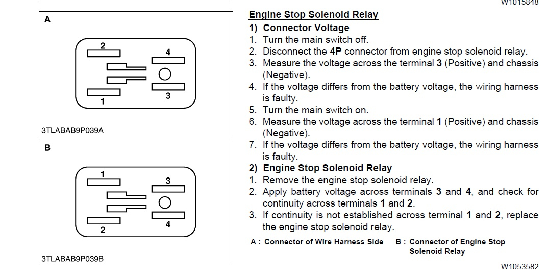

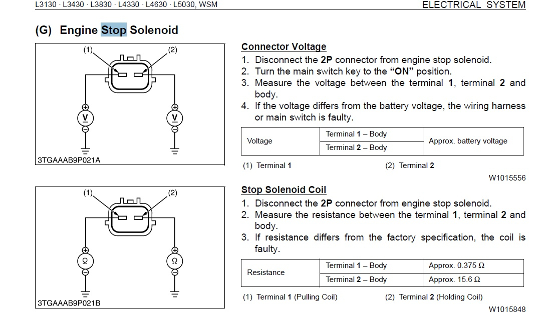

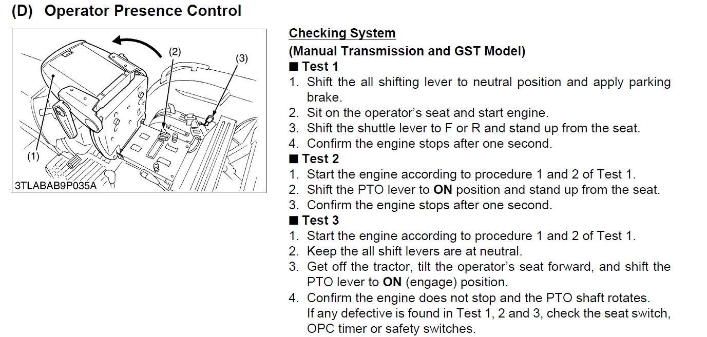

   / ,Decoding Kubota wiring diagrams #6
You may find test diagnostic tests from the L4330 WSM helpful
The OPC aka Operator Presence Controller plays a major role in operating the stop solenoid.
Now that I see you have the GST I will look further.
Telling us about the symptoms may get you an answer not just help deciphering the wiring diagrams which are almost impossible to use to figure out how something operates.
PS Back with more OPC info. Read the attached pdf page with the description of how the OPC system operates.
Dave M7040
  • forum L4330 OPC operation.pdf
I traced the problem to the engine stop solenoid relay. Removed it, bench tested it, tested ok, reinstalled it. Now I have power to the engine stop solenoid, unlike before. Don't know what happened to fix it, but it's working now.

   / ,Decoding Kubota wiring diagrams #10
Hi, FTG.. Dave.. and everyone
I am also having a "gremlin" in fuel stop solenoid circuit, but my L4330 is an HST. Dave 7040, the diagnostic page you posted for FTG's GST seemed like a good resource. Do you have a page for and HST that you could post? It would be mucho appreciated. I did some tinkering today I fiddled with the "key Stop" fuse and could hear the fuel stop solenoid clicking. I pulled inspected and reseated the fuse and tractor ran fine for an hour and then started shutting down again.
