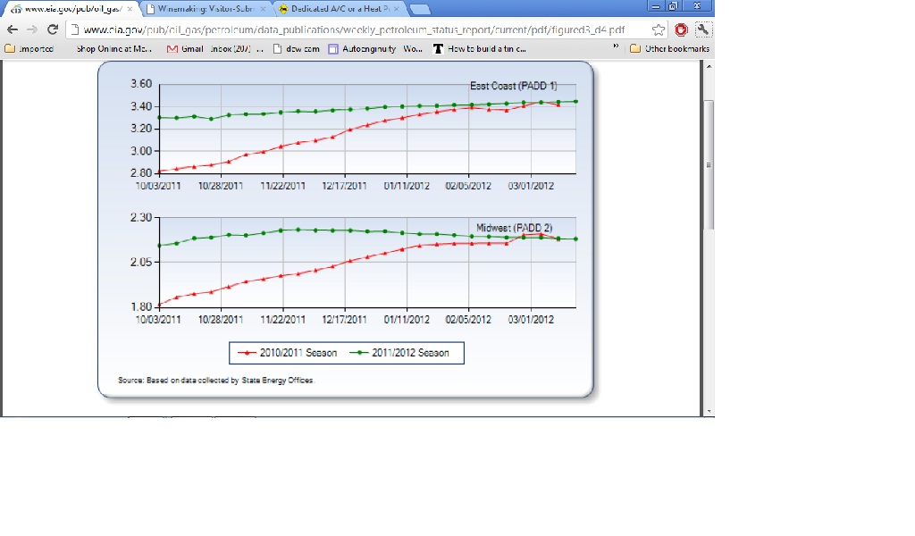

After much experimentation on my air source heat pump I left it at about 50 degrees. Natural gas was too cheap not to burn. With propane I think I'd start at around 35 degrees and go from there. Your fuel costs will be higher for the backup heat, so the break even point will be different for you. Remember that you'll have additional wear and tear on the compressor when operating in heat pump mode - you can hit the same number of operating hours in 8 years instead of 16.

Ultimately when deciding to go between a straight heat pump or dual fuel (and the added cost of a furnace for second stage heat), you should look at your fuel costs as well as your operating tempertures to give you and idea of what kind of ROI you're looking at (if you're on LP it's a no brainer if you're in a colder climate).
