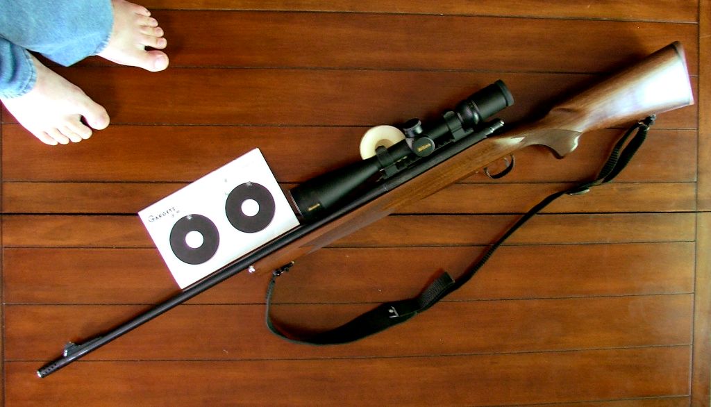

N80, if you are interested in shooting with Iron sights, maybe I could interest you in a Remington 700 "Classic" which has iron sights from Williams ? It is an 8x57. I am on the cusp of "bubbafying" the rifle, but if someone wanted it as it was, I may not feel bad about it...
In the picture below, it had a Nikon 4-16x50 scope on it, but you can see the front sight and muzzle break and the rear sight is just behind the scope objective and is fully adjustable.
