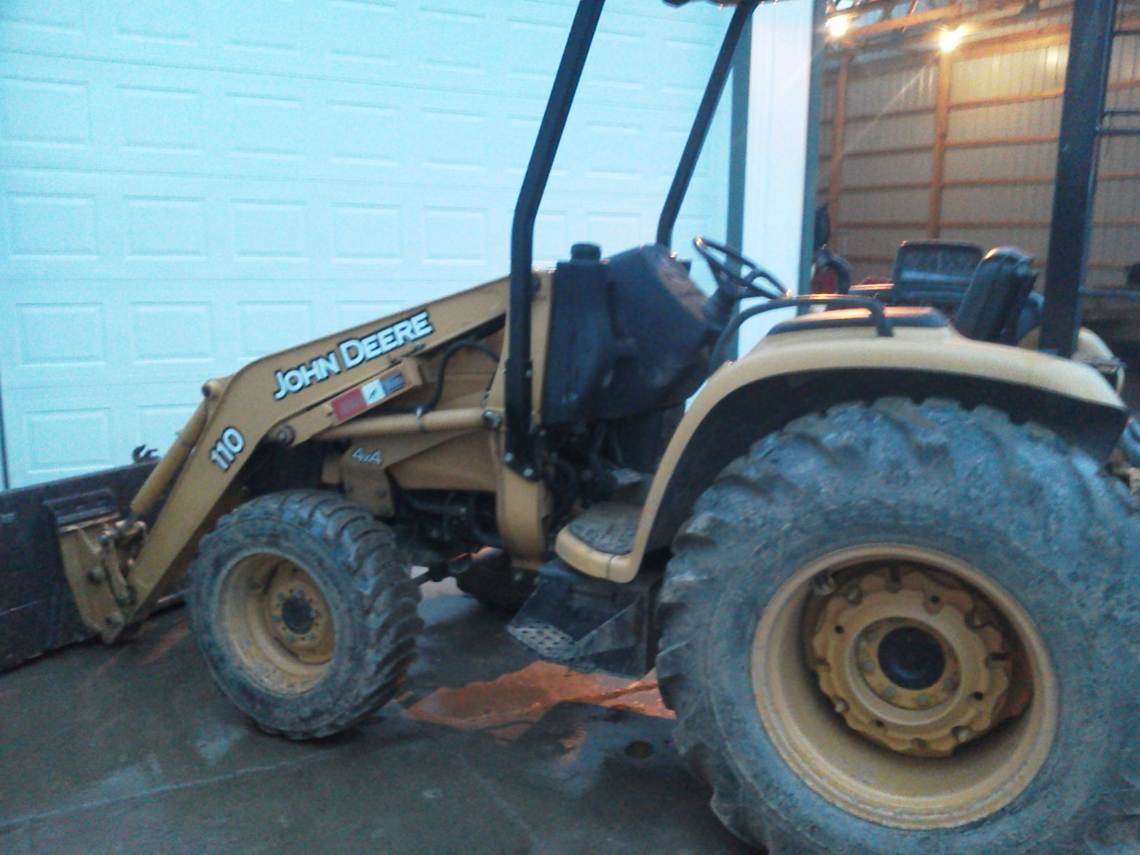

I can not speak of traction issues from personal experience, but Metal wheels weights can be added to help, and are removable for 'hoe work. I have run a pto chipper, and have had no issues. The first time the hoe is removed it will take some time to get the hang of the removal process, and the pins might be 'stuck' a little. Remember to have the engine off when working with hydraulic couplings. I plan to use a sub soiler with a cable layer/trencher attachment to bury some pipe in the coming months. The highly recommended skid plate would also add some low weight, and therefore traction(and stability), as would the drawbar hitch kit (not worth buying just for the weight, but If you really plan to use it as an ag tractor, it would be useful) here's a pic of weights on a 110 tlb.
