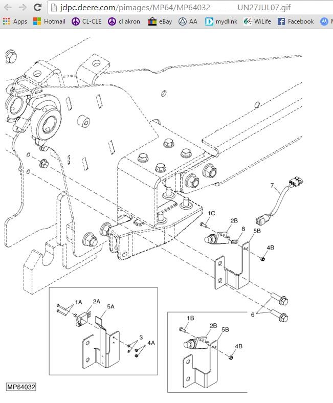

Update on troubleshooting. Every wire I could get to has been checked. Everything to/from the engine, harnesses, fuel cutout, etc are all good as are the front grounds & underbody grounds. I abandoned using the brush hog & kept the hoe installed. No issues for 112 hours. I've 'toyed' with the backhoe presence micro-switch and have found that it sticks. I can simulate the failure and blow the fuse if the switch thinks the backhoe is present and the pto switch is pulled, but I remain convinced there's a wire issue. Next-as soon as the weather goes bad I will drop the hoe, right rear tire, and right fender to get to the last areas to check. Much work but I will find the issue and report back so the next guy has an easier time of it.
Meanwhile, about the sticking presence switch, this is not a new issue for the older 110tlb's. Deere even updated the design, think in 2004/5. Has anyone done/gotten a retrofit of the newer presence switch set-up on an older 110tlb ? Here's the 2 designs they have, 2003 (the older one) is the lower left.
