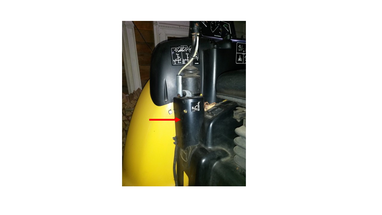

I'm wondering if I could get some Deere 110TLB parts help. We need to do a repair on the loader joystick similar to what BILLSTMAXX on Youtube had to do (fixing the loader joystick and Hooking up the homemade backhoe bucket to the 11 tlb - YouTube)... We want to replace broken cover below the actual joystick. The red arrow is pointing at this part on the attached photograph. But remarkably, our local Deere distributor can稚 find the part number
Has anyone done this repair, or know enough about Deere part numbers to help us out? Thanks in advance.

if you're after #4 which looks like what you want, it has to be purchased as the complete assy shown inside the box

Thanks, but we're looking for the cover that goes over everything below 4. The plastic cover that the red arrow is pointing at in the picture I uploaded.

#24?

I think you found it! Good job joecdeere :drink:

The "SCV Lock" decal needs to be ordered seperately. Part #LVU13564.

Yes, that's it! You're the best!
