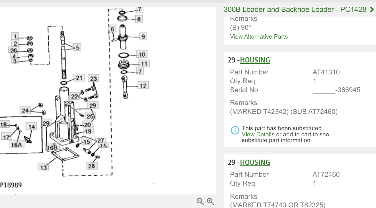

The one from All-States is the one I purchased. The part number for just the housing (I found on JDParts) is AT41310/SUB AT72460 and listed for $3200 which is what I have had no luck finding. That RE10800 says it fits a construction and industrial 300; not sure what the difference between 300 & 300B is. I appreciate the help

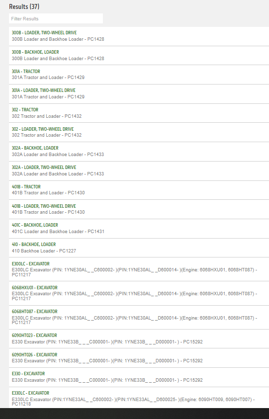

What's the casting # on your All-States valve housing? 300B is just a similar size to 300 tractor but later manufacture dates. Model 300B has a serial break on steering valve housing. The dog bone shaped part(item 12) fits 37 other models but not a model 300

There isn’t a number on the All-State housing; the number on the original is T82325. Not sure what the serial break means.. were there different styles with different serial number?
   / Deere 300B Steering Housing Obsolete #6
Serial break(stop/begin) on serial # when JD engineers changed from open center to closed center steering IE certain serial #
