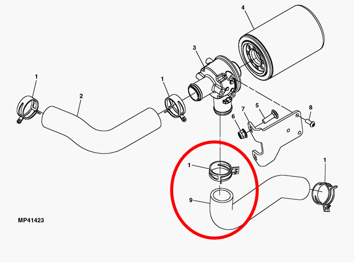

I was dragging brush in reverse from the edge of a creek with the loader bucket, and got a branch/limb snagged under the left-side of the tractor. It pulled-off the low-pressure hydraulic return hose from the filter assembly, causing loss of control and movement. Hose (#9) in the image was knocked off of the filter assembly (#3).
I loosened the spring clamp on the (1-1/2") hose, and reattached it to bottom of the filter assembly. Then refilled the almost five (5) gallons of hydraulic fluid I had lost onto the ground. All good so far. Regained control of the bucket and transmission. :) So far, so good. I was able to drive back up the mountain to the house, and give the tractor a thorough inspection.

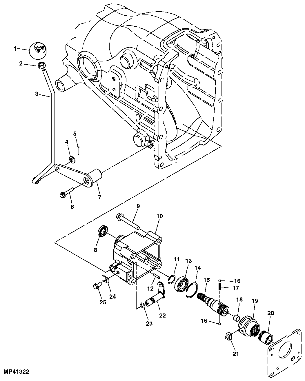

The 2wd/4wd lever (#3) goes through the floorboard, connecting to an arm (#7) that connects to a shaft into the front-left side of the transmission (transfer case?)
Everything appears physically attached, and the shaft rotates when the lever is moved up and down. But, something is not connected. :confused:

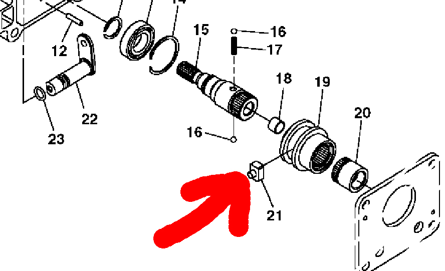

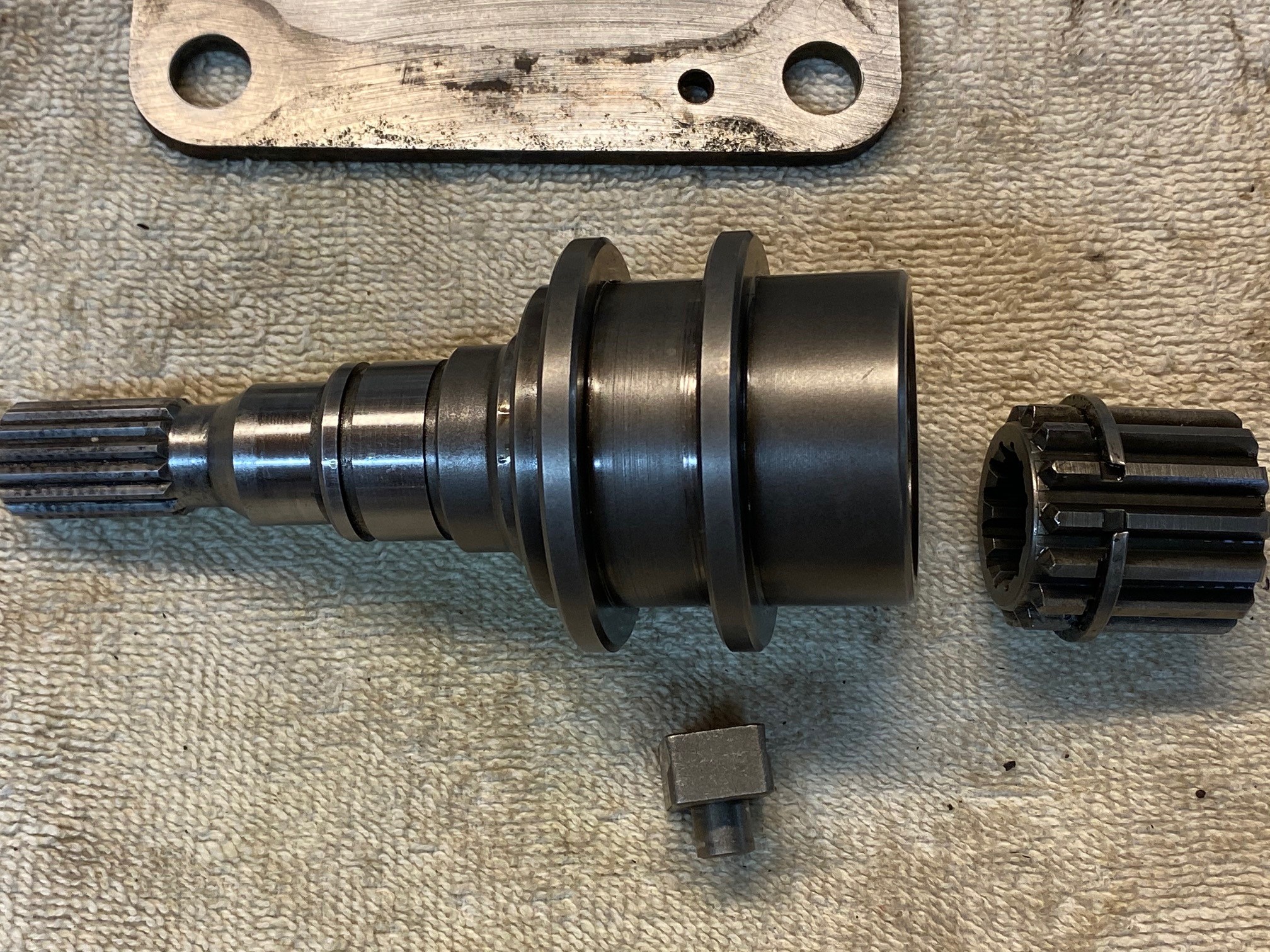

The 2x4/4x4 shift lever though some linkage controls a sliding collar which engages and disengages the 4x4 on the tractor.
In the attached images (borrowed from Deere's parts website), the "Shaft" #22 (PN# LVU19323) moves the "Shifter" #21 (PN# LVU18520), which intern moves the "Shift Collar" #19 to engage/disengage the 4-wheel drive on the tractor.
In my incident, the "Shifter" #21 broke, and was not moving the Shift Collar. Attached are two images.
The first one is the parts diagram of the shifter.
The second is the blow-up view, that I have marked in RED what broke.

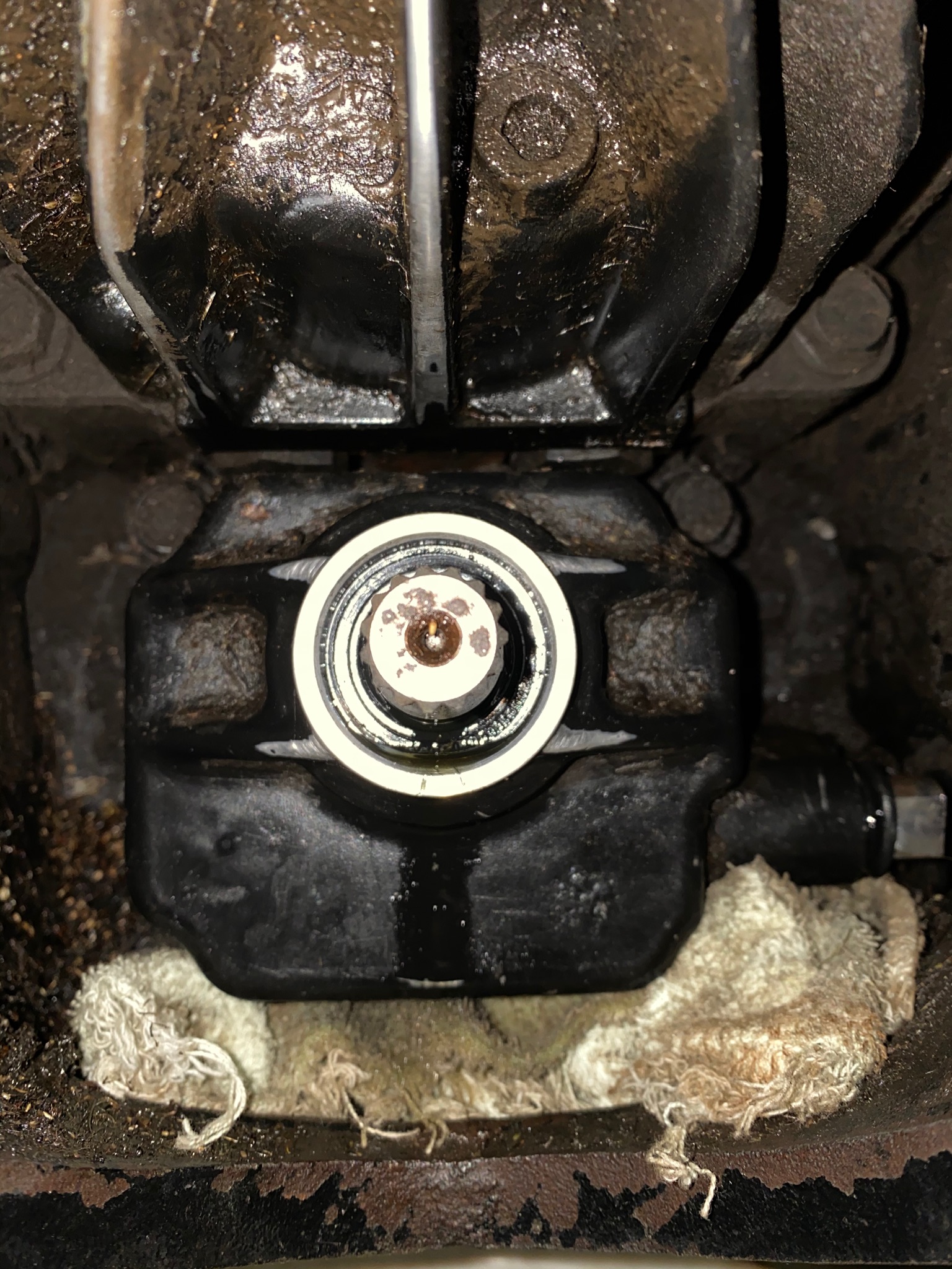

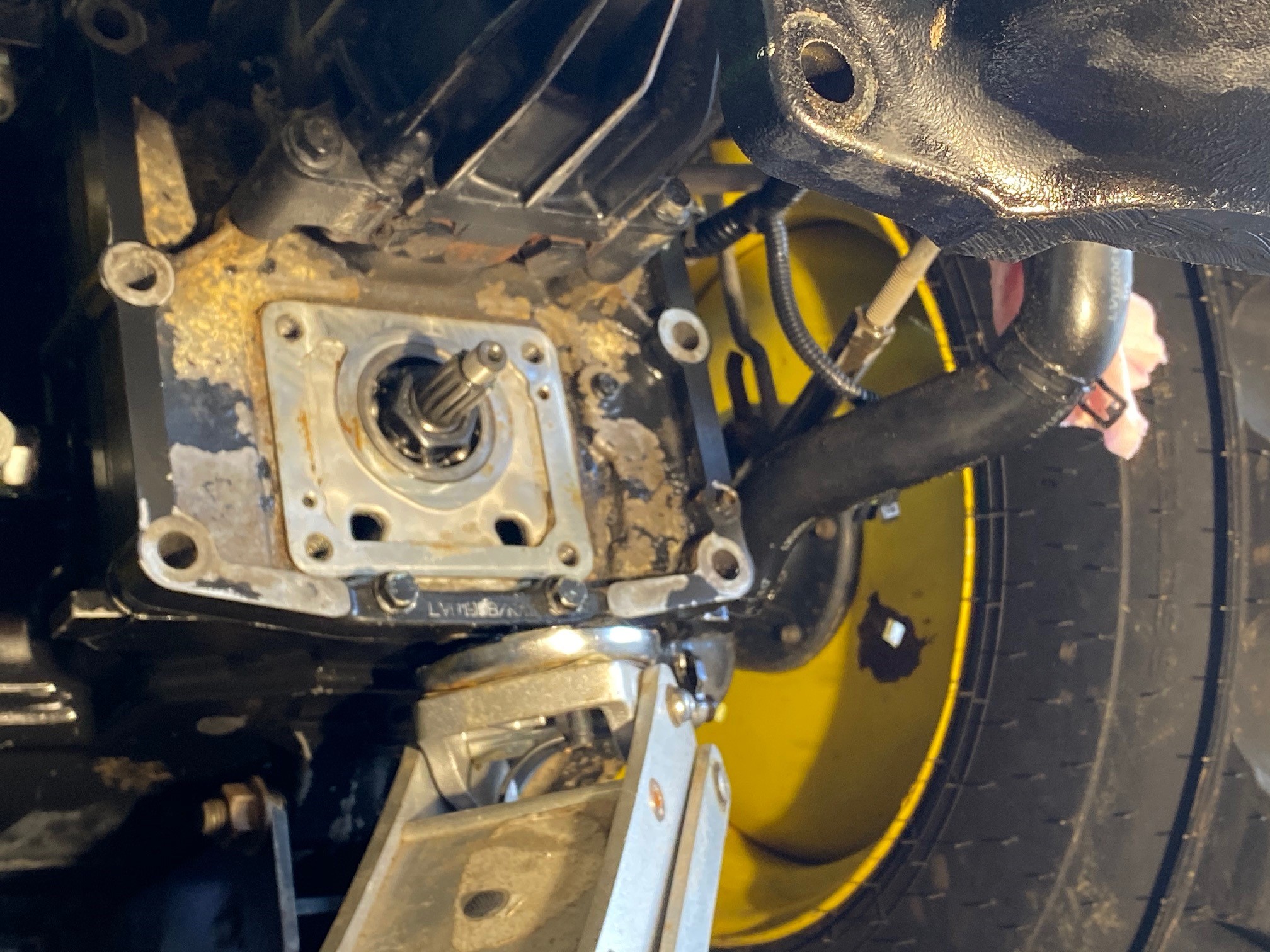

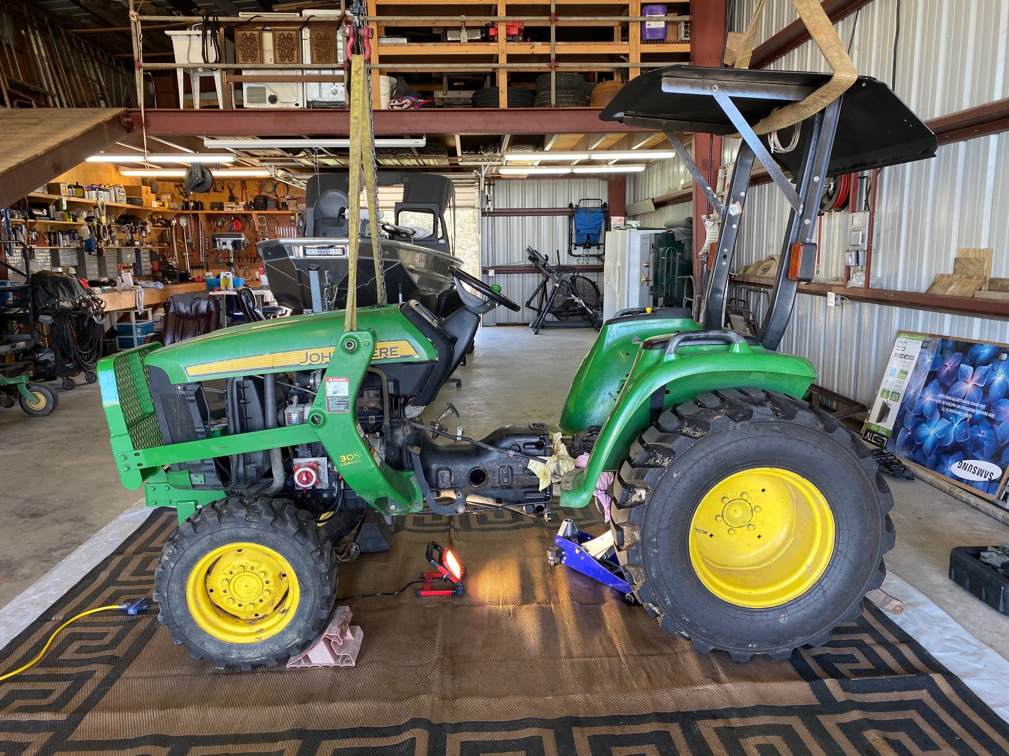

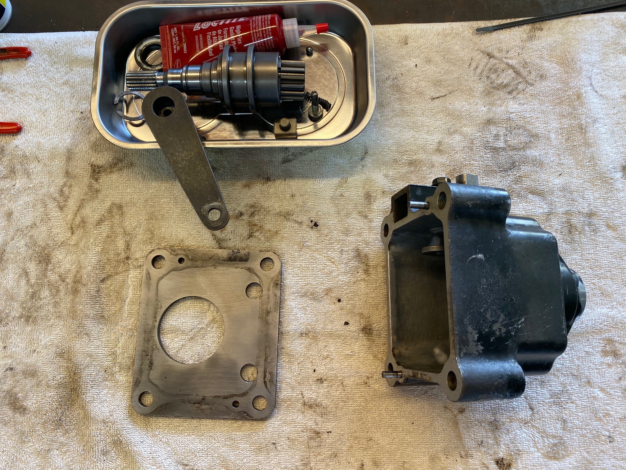

Did you or the repair shop have to split the tractor in half to make the repair? My seal is leaking and I cannot get the 4x4 shift housing out of the tight spot below the tractor because the opening is not large enough. 6F1FB76A-DF44-4567-A0A0-EC973A5AA74F.jpeg

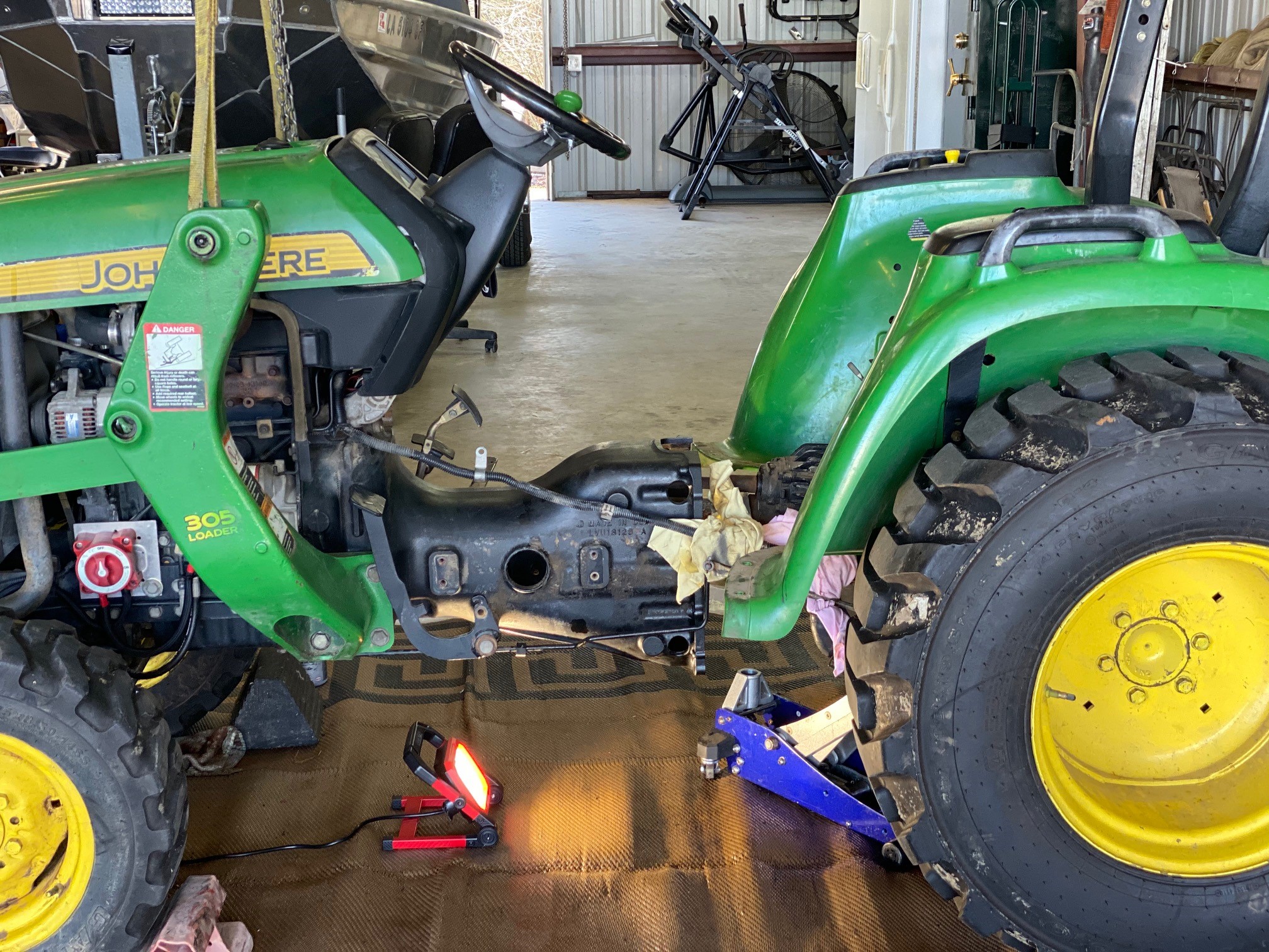

Did you or the repair shop have to split the tractor in half to make the repair? My seal is leaking and I cannot get the 4x4 shift housing out of the tight spot below the tractor because the opening is not large enough. View attachment 631280
Did you ever get a resolution to this problem? I have developed a similar leak in a 2012 3032e and it appears a rear split is the only way to remove the MFWD housing.
