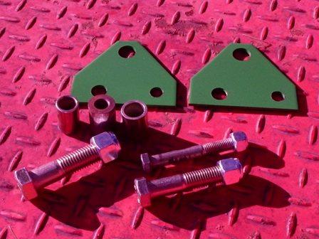

I wanted to make my 550 tiller work with my new I-match and this is what I come up with. The brackets were cut on the Ironworker at welding school, and the bushings are regular Category 1 to 2 adaptors from the dealer. I did turn them down for length on an ancient lathe at my buddies shop.

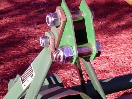

Here it is mounted to the tiller. No permanent mods to the tiller were neccessary.

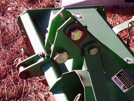

Another view.

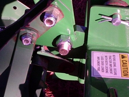

.....and hooked to the I-match.
