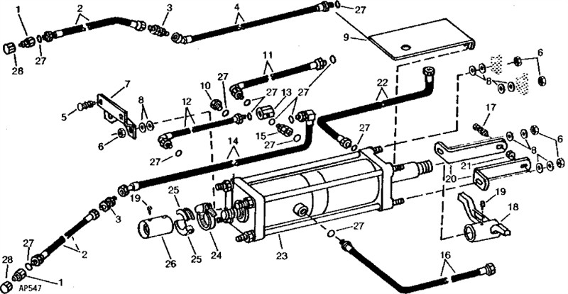

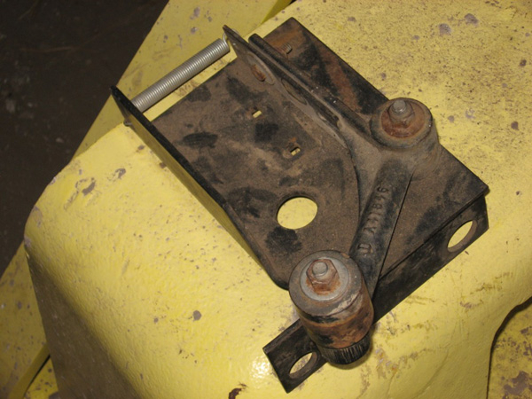

Several years ago I modified a 12 row folding planter into a 6/11 splitter. Changed the way the master cylinder actuates the seed clutch and marker alternator switch. Want to go back to original way the marker switch was mounted, but don't remember and can't find the details in the parts catalog. I've tried it every way I can think of, but nothing quite looks right, or doesn't provide control of the cylinder rod to it can't rotate. Can anyone post pictures showing the mounting/actuation mechanism for the switch and clutch and how the rod is kept from rotating?
The attached images are an exploded view of the way my cylinder was set up, and the switch mounting plate that I can't figure out how it goes back on or what pushed the bellcrank arm. I can see where the switch was mounted and it looks like the spring was what actually pushed the button on the switch, but what pushed the bellcrank?
Thank You
Craig
