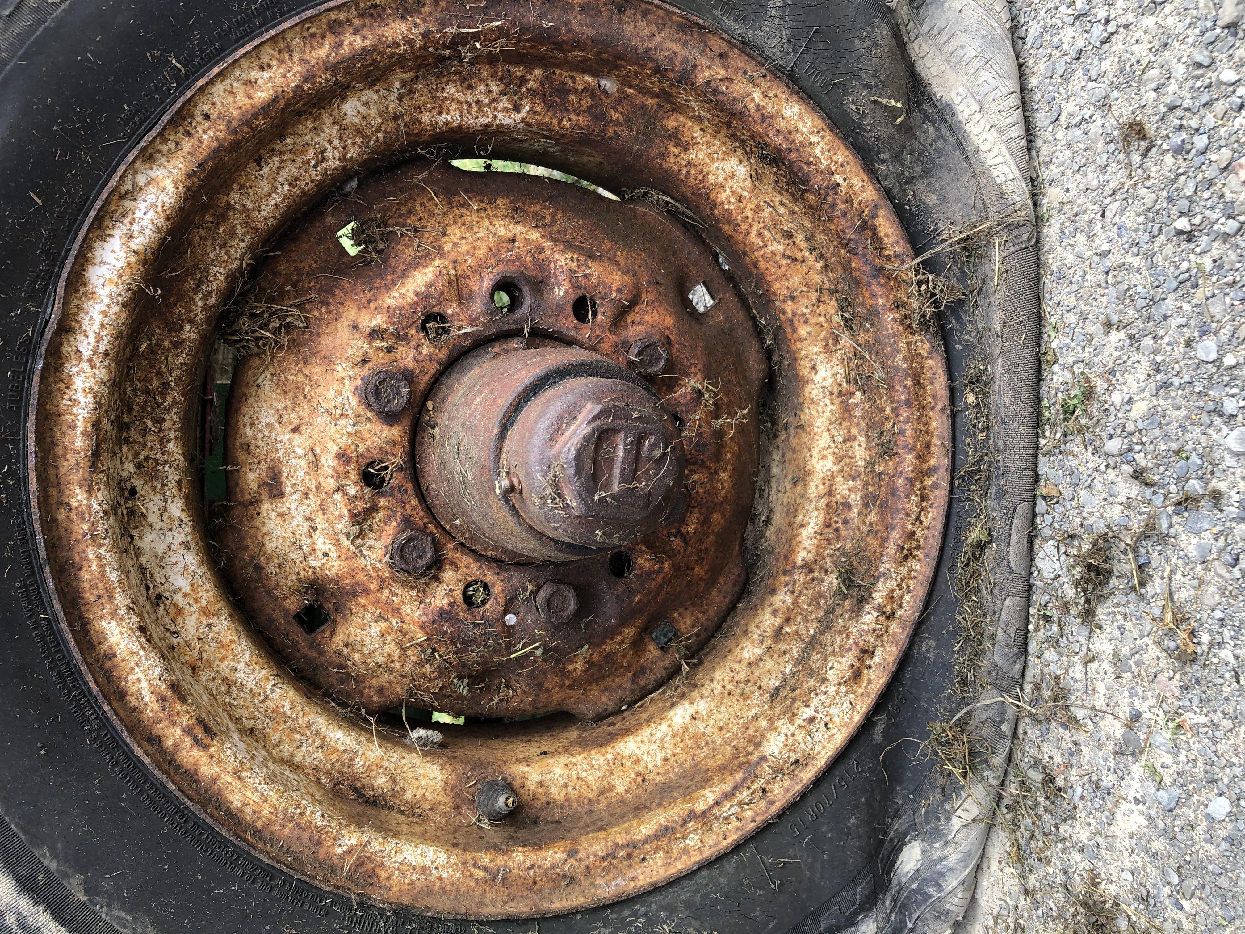

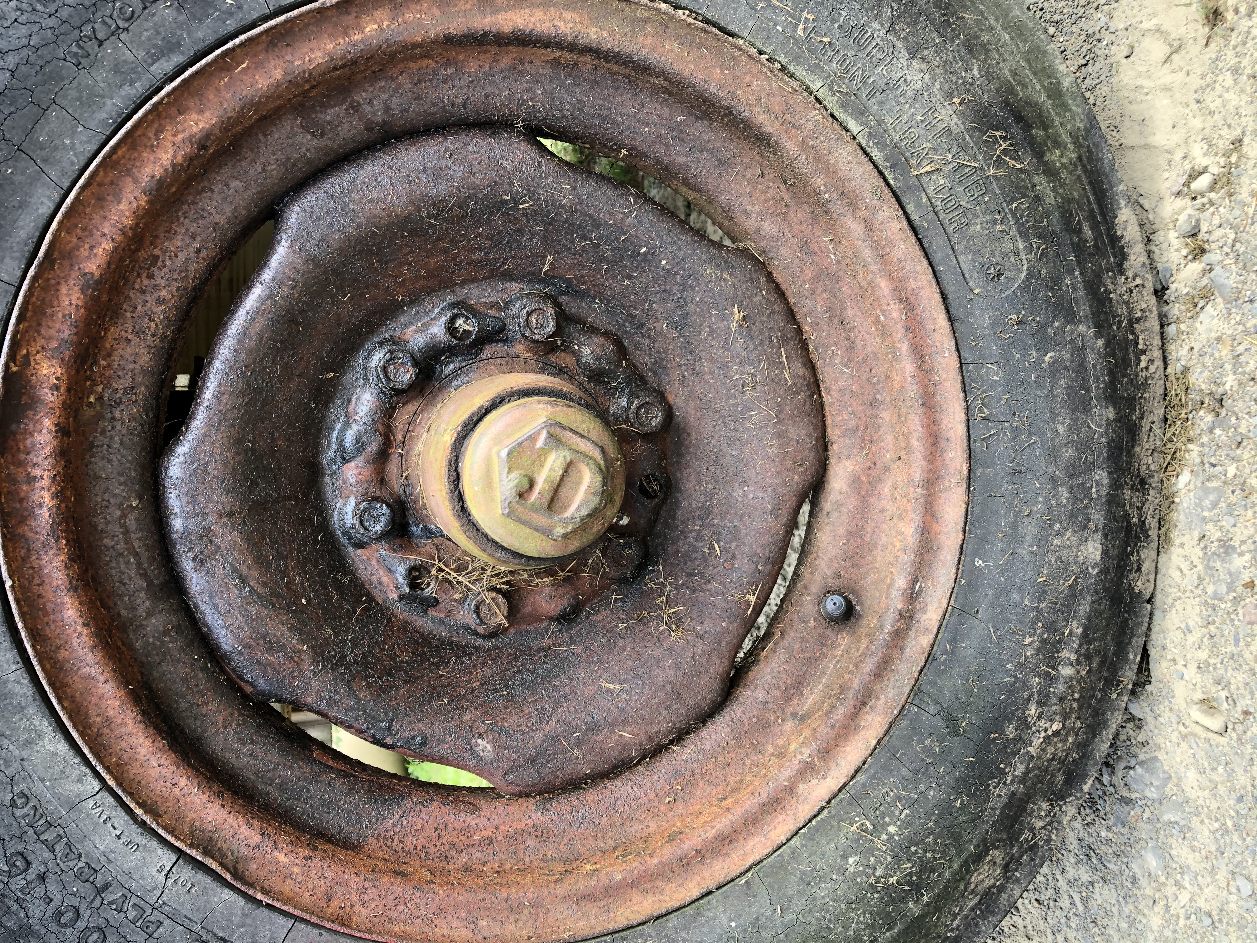

Hi folks:
I'm trying to locate wheels to fit a JD 953 or 963 running gear. The original wheels were standard 6 bolt with either 16" or 15" diameters, but the mounting face is a bit weird to fit the hub. A typical 6 bolt wheel (implement or otherwise) does not seat properly on the hub. I have also heard of spacers that can be used so that any standard 6 bolt wheel can be used. Can anyone lead me to a wheel (or two) or the proper spacers?
The 15" wheel on the left is not the proper wheel. See how the does not seat securely on the hub, leaving a space. The correct 16" wheel on the right is original. It fits perfectly on the hub -- you cannot see any space. If you click on the pics and expand them you can see how perfectly the wheel and hub fit in the right pic, and poorly in the left pic.

Thank you for the suggestion. I checked out Gemplers and other places and can easily find 6 bolt patterns with 4.5" center holes. But in reading other threads on several other forums from folks with the same problem, the typical wheel does not fit as the hub is odd. My ill-fitting rims on the front axle hubs demonstrate this. Exactly what that difference is I have not fully investigated. Perhaps that is next.
   / Deere 953 and 963 running gear wheels
I've gone out and made some more measurements on the non-OEM rim and the running gear hub. The hub face is 8" diameter, but the concavity of the rim only allows proper seating of something about 7.75" diameter. I can turn the rim around and the hub will fit on the convex side (not great, but better), but now the valve stem is on the inside.
I've been looking for 1/4" thick wheel spacers, with 6 bolt spacing (6" center to center), overall diameter of 7.75", center hole of 4 5/8", and bolt hole diameter of 5/8"
