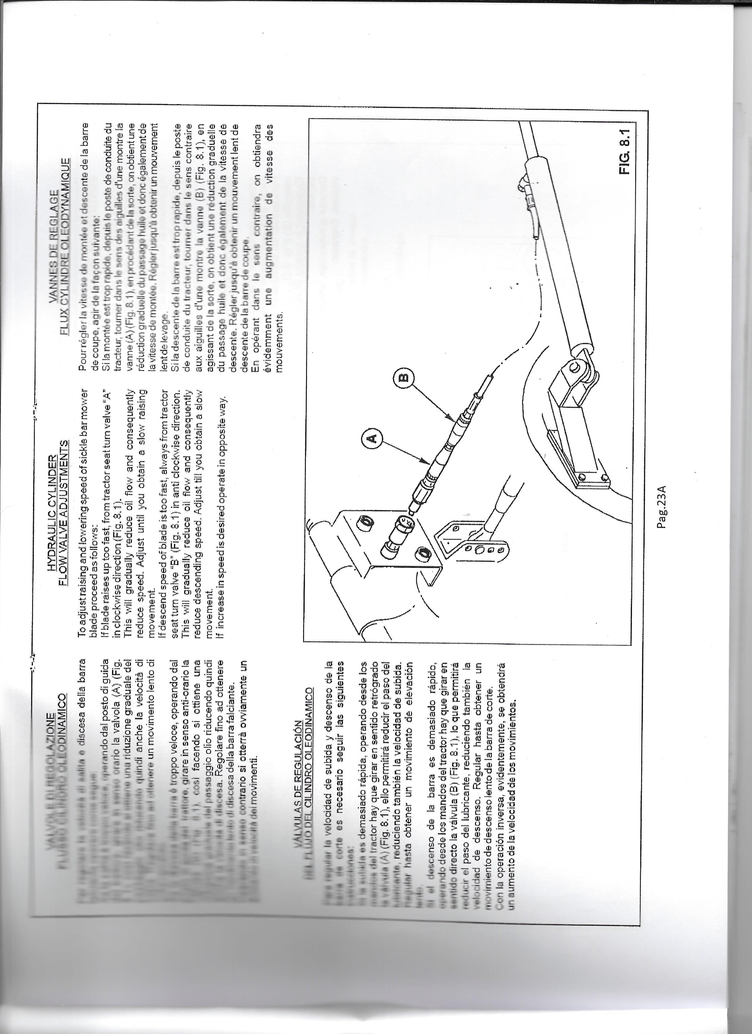

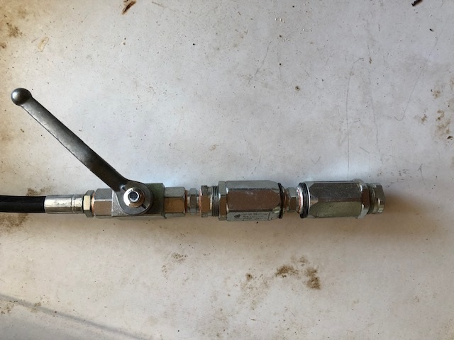

Hi,
I have hung an Enorossi mower off the back of my 955 with a single hose hydraulic lift piston for the sickle bar. The Enorossi comes with a single inline valve with a send and a return flow adjustment inline valves. I am unsure what/where I could plug this into the Deere. I certainly do not want to separate the rear backhoe hoses; but wondered if I could use one side of the bucket tilt on my loader. Has anyone operated a single hose hydraulic piston off a 955? Where on the 955 do you attach a single hose? Or do I have to have a dual hose hydraulic piston and dual hoses? (The Enorossi single hose just returns oil by gravity feed like a power lift trailer)
The photo show the inline 1/4 turn control valve while the Enorossi send and return flow diagram does not..

I have operated a one-way(single hose) cylinder on a Kubota M4900 & my friends Mahindra tractor by utilizing one breakaway coupler on a the loader bucket circuit. Both your tractor & mine have similar open center hyd systems so I see no reason it wouldn't operate the same on your JD. The valve in your 2nd photo appears to resemble a transport lock similar to the transport lock valve my Krone disc cutter has to lock cutter bar in 90° position.
