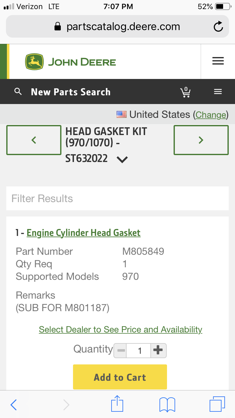

Is this not your head gasket? What痴 your part number?

Yeah, that's it Timberhole.
When I call Deere they all say, "Yeah, the number is in the parts catalog, but it's no longer available."

I just called our local Deere dealer and had them run the part number (M895849). They say there is one in the Atlanta warehouse but it痴 the last one. They did confirm that part is discontinued. Send me a message if you need more info.

I talked to a different parts person at my local Deere dealer and told him that some other dealers WERE indeed showing one M805849 head gasket in Atlanta.
I'll have the OEM Deere gasket by Friday.
