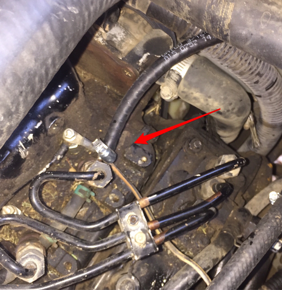

I had a chance to work on the mower and did not find anything near the tank that was suspicious. Turning my attention towards the fuel lines, I found the return line from the injectors appeared to be cracked at the clamp when I bent it. This seemed like a possible source of a slow air leak though I couldn't imagine the air at the point would cause a problem. I replaced the line as shown and put a hose clamp on it. The mower ran fine for an hour after I did that. There were a couple of times it bogged down on a hairpin turn but I was able to mow the lawn. Anyone think a crack at that point where the arrow is would cause the delayed stall I was having?

I wouldn't have thought so. It seems like a crack there would help more than hurt. If it works, that's good....although I am another old mechanic who isn't comfortable by fixes that don't make sense. I'd almost rather think that you messed with the cap and it began to vent again.
Because to me those sympoms all sounded like the typical "vacuum in the fuel tank" caused by a non-venting cap. Those caps were originally designed to be taken apart and the vent cleaned. I didn't know about the strainer being part of the vent system.
Anytime I hear of anything that sounds like a fuel flow problem the first place I look to is the fuel filter and the lines to and from.
I once had a fuel tank that had small pools of water in the bottom. I could see them by shining a flashlight into the tank. Over the years they built up a small pool of water that got pushed though until I could see maybe a quarter inch at the bottom of the clear (cloudy) filter housing. But even so, there was no effect on running.

Well rScotty, we may never know because I DID mess with the cap and have since kept it cracked. Did a 90 minute mow today and all was good. :laughing:

I agree with rScotty that leaking diesel return line won't affect how engine runs but will make a smelly mess.
