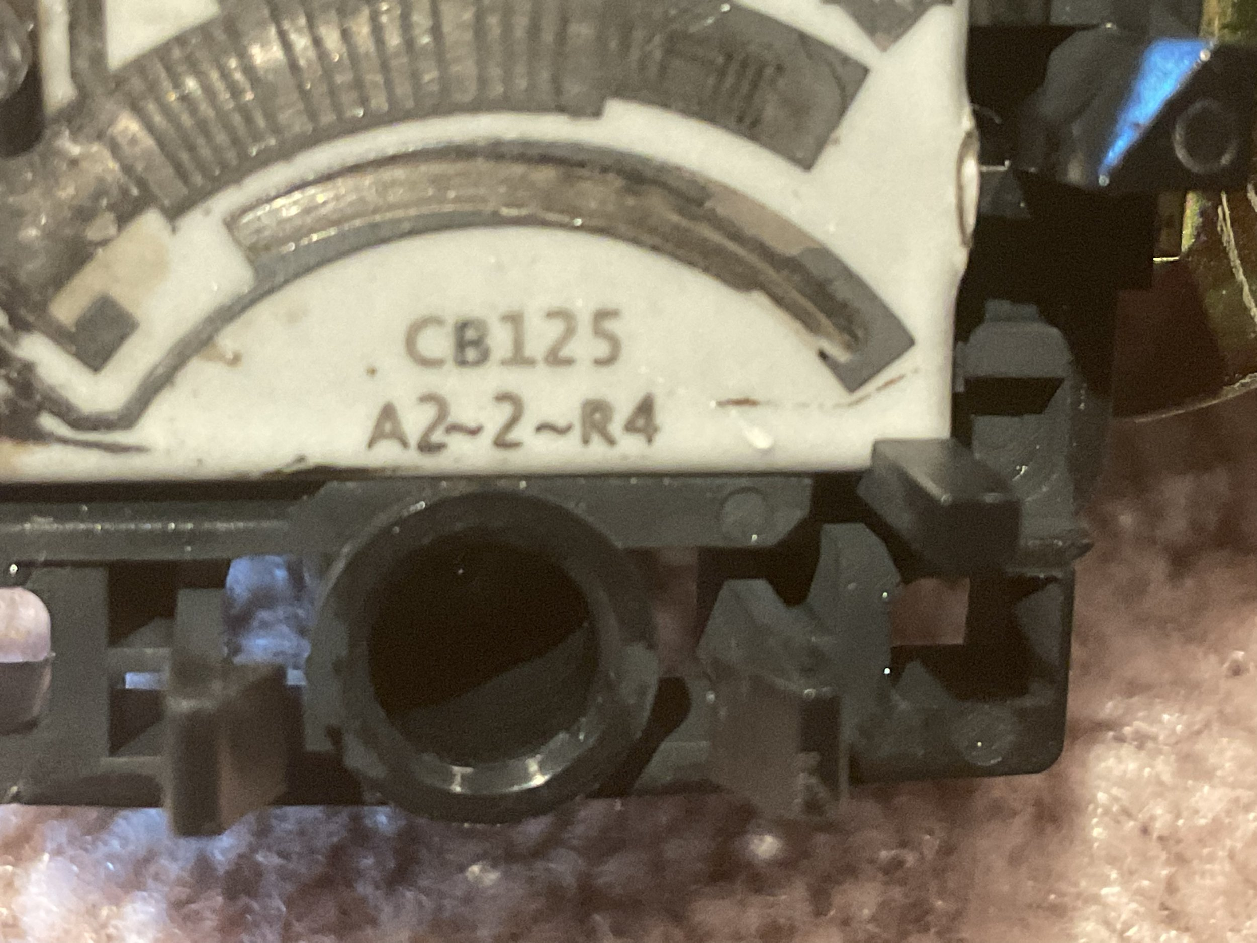

Good morning. I have a Deere x475 with a fuel gauge that stopped working. I’ve found the problem to be the fuel gauge sending unit. The small board the float pins contact is worn out. So far, I’m having a difficult time finding a replacement. The small board has a couple numbers, CB125 and A2-2-R4. Believe these part numbers are for the board only, not Deere part numbers. Haven’t discovered the manufacture of the fuel sending unit. Has anyone had any luck finding a replacement part?
Appreciate the help.

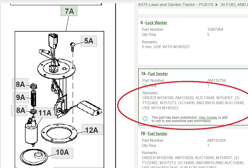

This is the fuel sender I’m needing.
Thanks
   / Deere x475 fuel sending unit
Thank you for the part numbers. Didn’t see the part I need. I think part of my problem is JD redesigned the fuel tank, pump and sender.
Appreciate the effort.
   / Deere x475 fuel sending unit #7

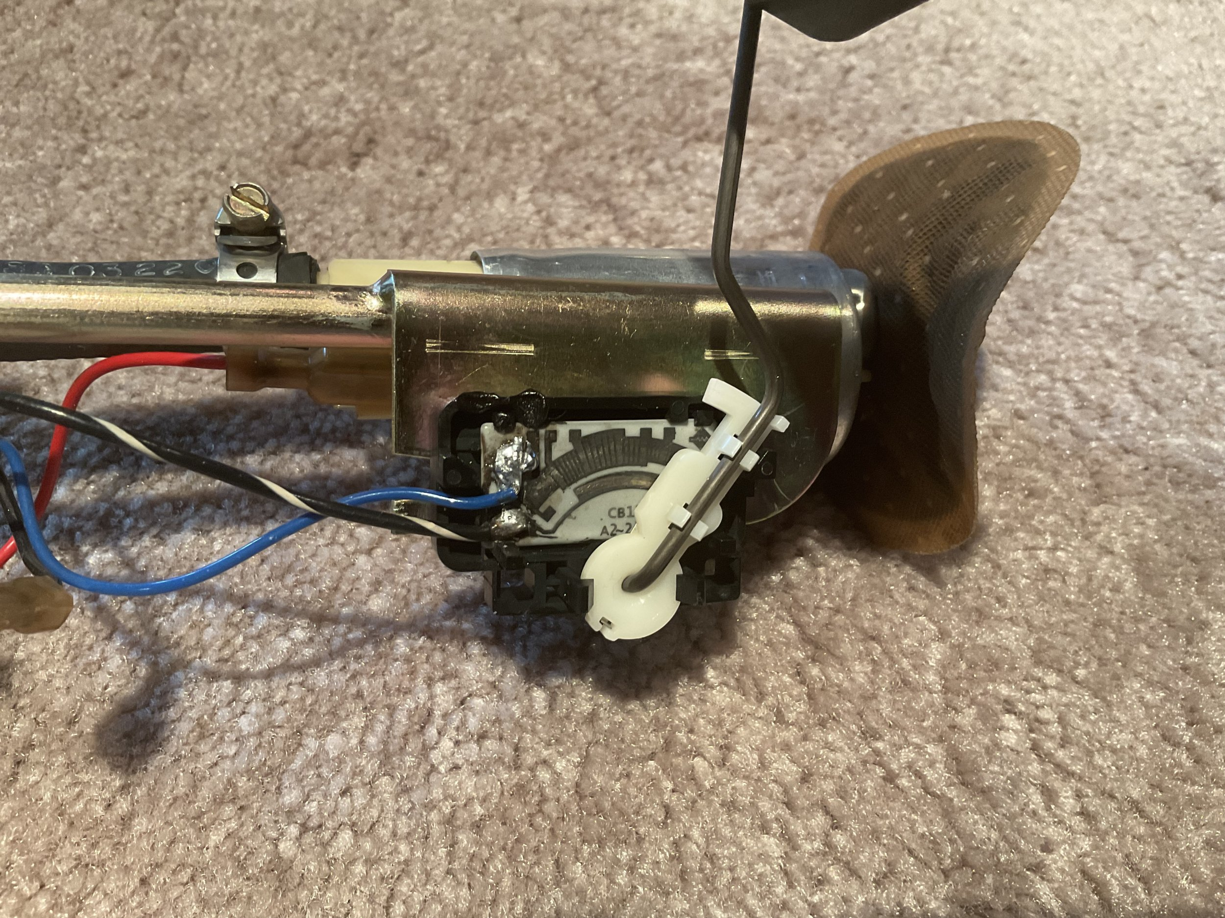

Looks like someone has already soldered some repair wiring to the unit?
The OE unit has been superceded and you don't want to be replacing the entire fuel tank to enable the upgrade.
I suggest you contact someone like NAPA for a generic sender or
These guys may be able to help.
The card from the 5-bolt sender should be ablt to be adapted to your in-tank unit and maybe the Meter-Match device can aid calibration.

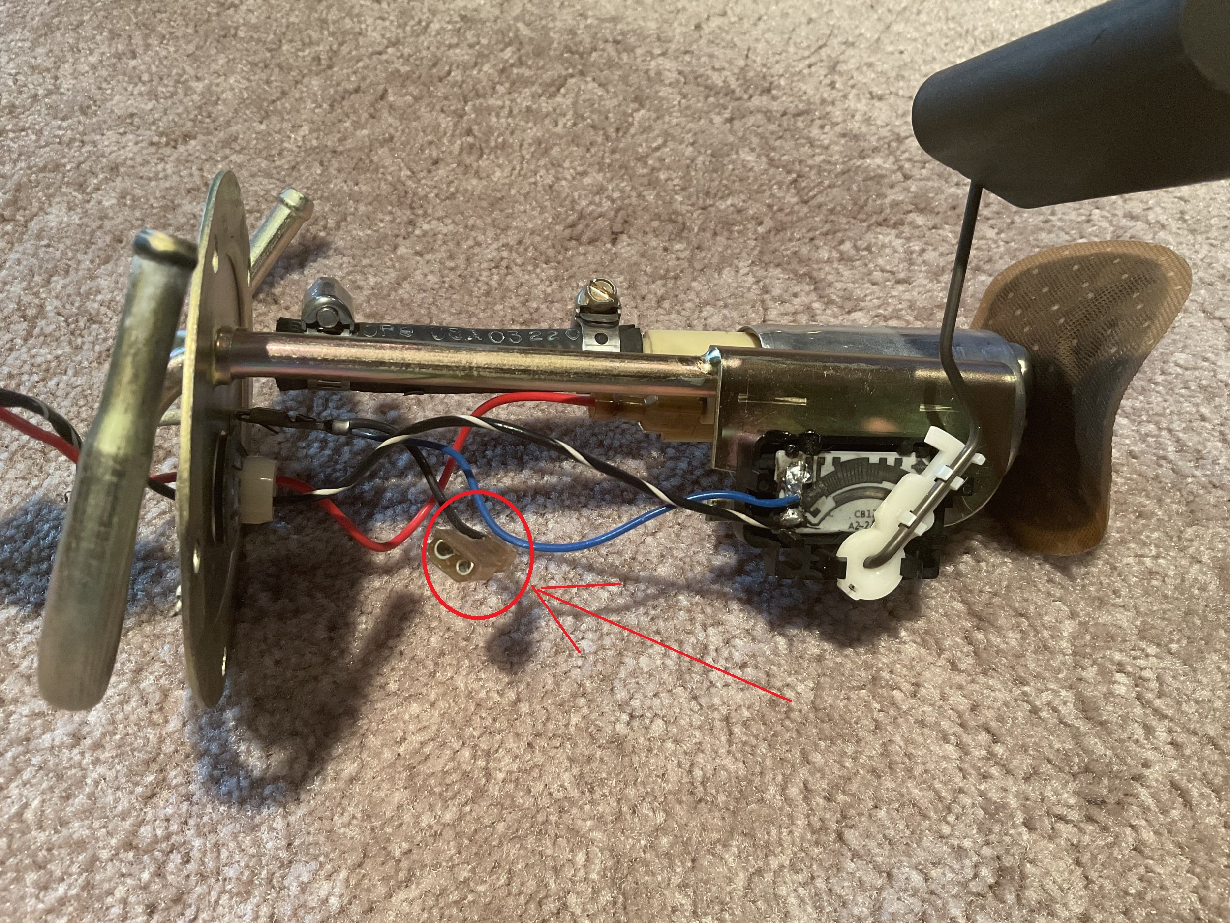

What does the connector, in the red circle in this photo below do?
The connector goes to the fuel pump. It’s disconnected so the fuel pump doesn’t run while the assembly is out of the fuel tank while testing the fuel gauge.
