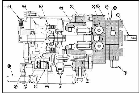

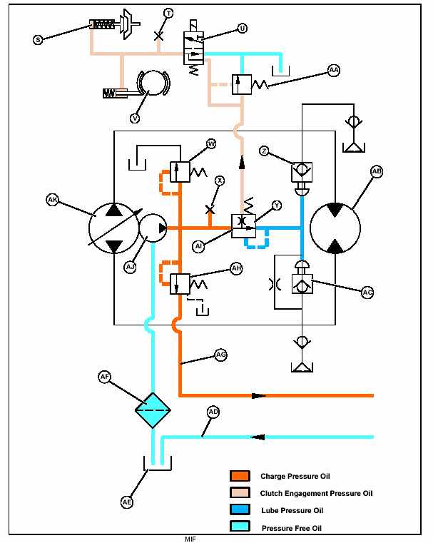

This might help; I think the valves are W and AH
   / Deere X585 Hydrostatic Relied Valve: A Question #9
Top drawing of our rear axle;
