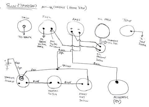

As to how to wire it in, that is as easy as any wiring job gets.....
Remove (pull out) or tie-back and tape all but the main battery B+ wire from the old group of wires to the alternator. Install the Delco, then connect the B+ wire (12V connected to battery) to the B+ stud on the alternator. You are done!
The regulator in the Delco draws a *very* small amount of current at all times and it will charge automatically without any additional wires.
Battery + -> Alternaor B+ and that's it.

My 1964 Massey Ferguson 135 diesel has a one-wire Delco alternator. Here's the wiring diagram I made when I disassembled the tractor for restoration.
You have to run the engine up to 1800 rpm or so to polarize the alternator get it to start charging the battery--one of the peculiarities of the one-wire alternator.
Good luck with your project.
