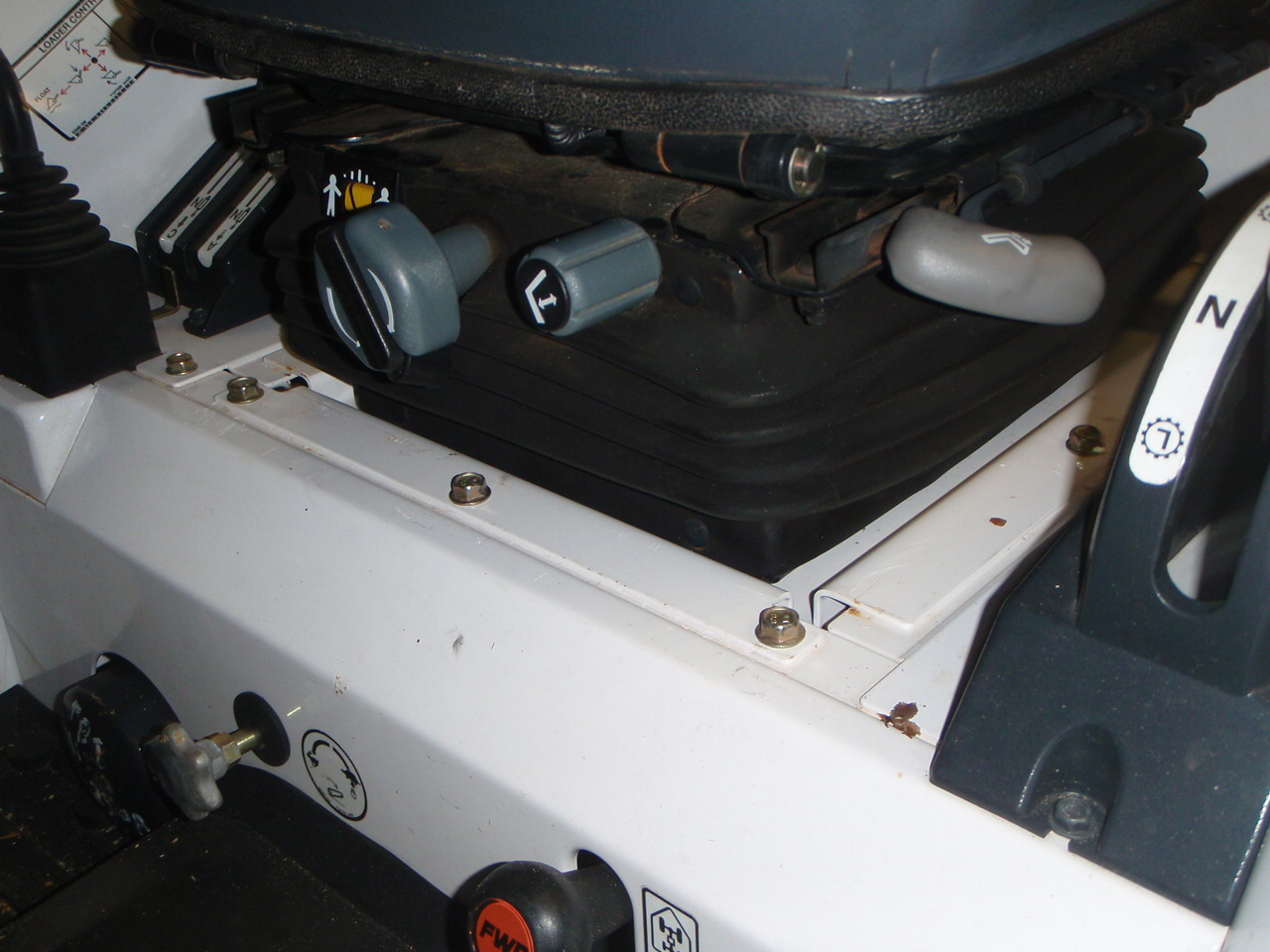

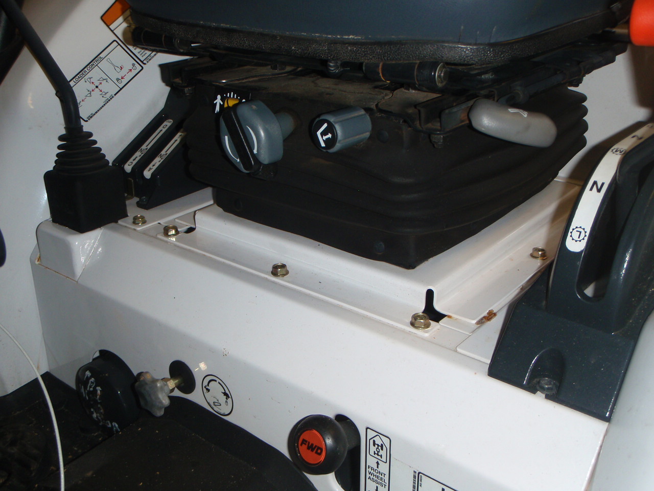

Fixed It! took about 25 minutes. I took off the seat and the mounting plate, reversed the mounting plate (plenty of clearance underneath) and re-attached the seat. lowered the seat about 2 inches. It also made a big difference when entering the machine, more clearance between the seat and steering wheel. heres a before and after.

oops! typo it only took me about 15 minutes to flip the seat bracket, and I was goofing around. (also killed that annoying weight sensor)
