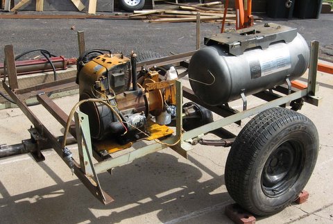

I am currently building a log splitter and have a question about how much hydraulic oil 'cover' must be over the suction and return ports in the reservoir tank to prevent 'whirlpool' air entrapment on the suction side and 'foaming' on the return side. The reservoir tank is being made from an old Craftsman horizontal 20 gallon air compressor tank that has two 1-1/2" bungs along the 'mid-line' of the tank, exactly 1/2 way up the side of the tank and separated about 18" from each other. The tank is about 18" in diameter and about 34" to 36" long.
The system will have a 1" suction line with a 13 to 14 GPM pump being run by a Kohler 10 HP motor. The pump is an old Sunstrand with an integral 'spin-on' filter (don't know if the filter is on the intake or pressure side of the pump as it is completely 'integral'). The pump and motor came off and old (late 70's) vibratory compactor. The pressure side of the pump will be run in 3/4" to the control valve. The control valve has 3/4" Input and Return Ports. The return line after the control valve will be immediately increased back to 1" to reduce the velocity of the returning oil into the tank. The maximum PSI in the pressure side of the system will be limited to 2,500 PSI.
I am expecting to have about 5" of oil cover above both ports in the reservoir tank. Will this be enough cover or do I have fashion some type 'downward' pointing piping within the tank to prevent both air entrapment and foaming of the oil?

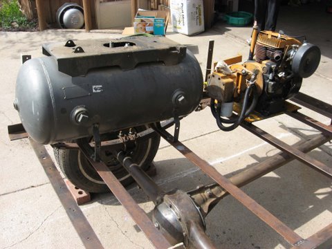

Attached are a couple of pictures of the beginning 'lay-out'. A 10" I-Beam is going to go down the middle of the trailer and stick out the back of the trailer about 4' for the loading of un-splits, the wedge and the 'splits' table. The 'passenger' side of the trailer will be a 4' aluminum diamond plate tool box for chainsaws and other tools.

It does not look like it would be to hard to modify the tank mounts (legs), and roll the tank about 45 degrees so the 2 bungs on the side would be deeper in the oil. Or, 90 degrees and they would be on the bottom.
DRL
   / Depth of Hydraulic Suction & Return in Reservoir?
Thanks DRL. I think that I will just go ahead and weld something up to direct both the intake and return downward inside the tank. It is not very much work and I would rather do it before filling the tank with oil and then having problems with it.
