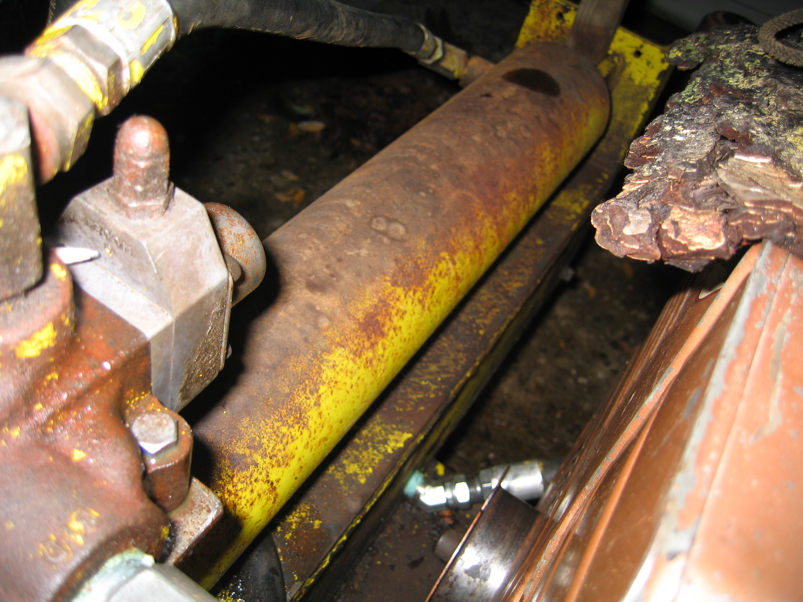

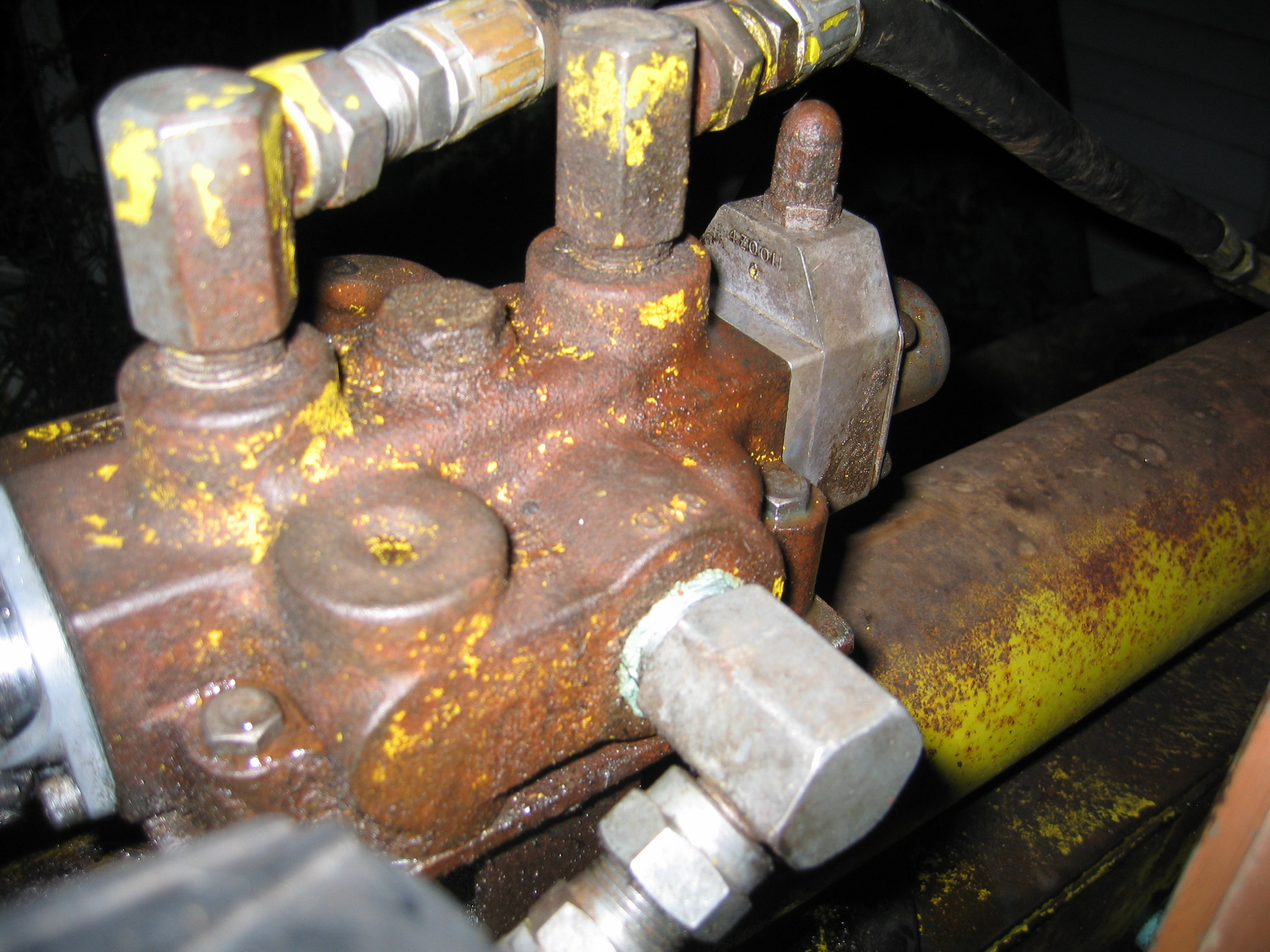

The valve body on the splitter is leaking. It's coming from a hole in the detent housing assembly. The only info I have is :
HA-80 / PA-80 directional control valve 4 way tandem center 2 position arn. circa '70'S. Is there a seal in the detent housing allowing a bypass? It looks like it wants to be a relief hole, but drips all the time, worse when retracting the ram.
   / detent housing weep hole... #2
You need new spool seals. The weep hole is there to drain oil that passes by the spool seal on that end and enters the detention housing. Should be one o ring on each end of the spool with maybe a back up washer on the outside of the o ring. Change them on both ends.
