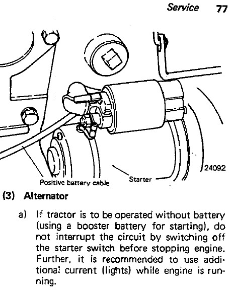

Your readings match what I found on my YM240 and posted here.
As CalG said, a diesel is most efficient at the hottest it can run without damaging anything.
Seems to me Yanmar's ultra simple design concept for the 240's intended that light as nothing more than a boilover warning.
How simple are these? There's not even a thermostat. Regen? Didn't exist 50 years ago. Fuel gauge? Nope. The three warning lights and the tach cover the essentials. The operator manual even allows running without a battery. A simpler machine for simpler times.
Edit - added:
runwithoutbattery-jpg.497137
