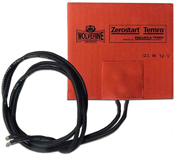

My concern with things like heat guns is that the temperature in the gun is so high that I worry that they represent a significant fire hazard.
I think that the prior threads had discussed that the Wolverine style stick on oil heaters are quite effective; one on the hydraulic tank, one on the Deutz. AC2204F2-F8A6-4033-ADEF-762FB42245FA.jpeg Available on Amazon. Make sure whatever you apply them to is oil free and squeaky clean.

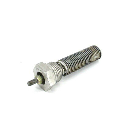

Having said that, if your starter can turn the engine over, Deutz air pre-heating coil(s) are said to be very effective. SpringHollow is a big fan. Just once the engine starts, give the tractor time to warm up both the engine oil and the hydraulic oil. I have not yet installed the coils, but they are inexpensive, ($30ish on eBay) though they require fuse, switch, and possibly a relay to be wired up. One of my larger diesels has a preheater that works amazingly well, and much better than the in cylinder glow plugs that I have had in the past.
I believe that for the Deutz 2011 engine that you want the coil style glow plug, like this;
I have seen ebay sellers advertising a different style glow plug that I don't believe fits/works for the 2011 engine.
