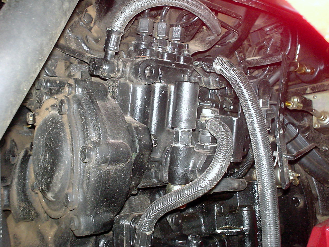

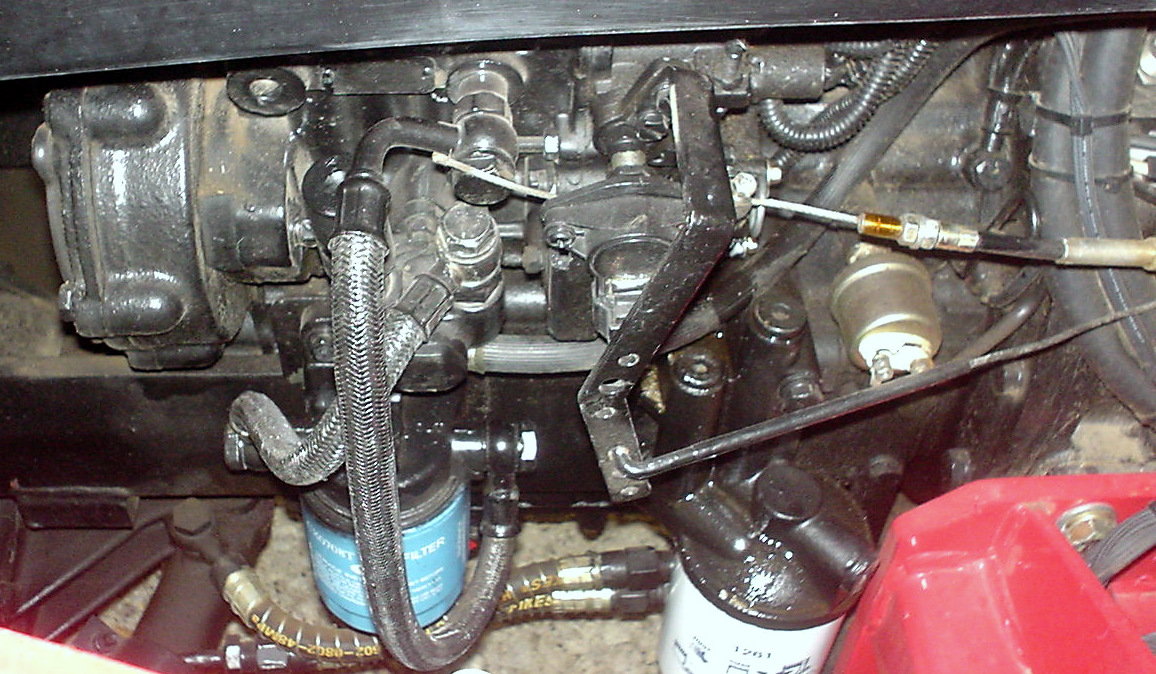

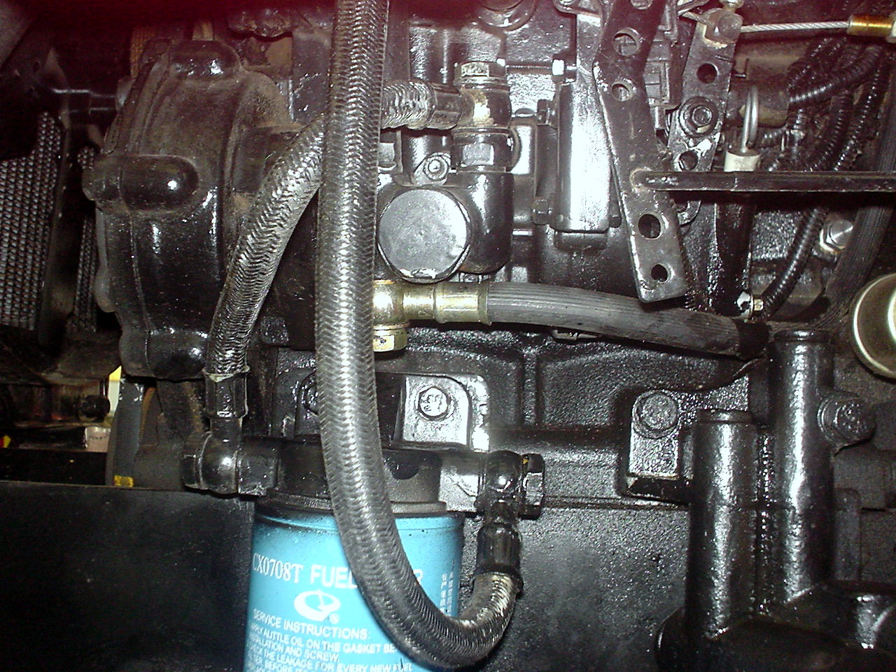

1-injection pump 1.jpg1-injection pump 2.jpg1-injection pump 3.jpg1-injection pump 4.jpg
I do not see any numbers on the lift pump. The injection pump has a paper tag attached but it is painted. Entire engine seems to be painted with thick black paint. I bought this tractor new and it came this way.
Engine plate says this (I think) Changchai 3LS25B which I also believe is a ZN390T.
These pics may help.
Thanks, Cleat
   / DF254 injector pump oil level rising. #6
My bad - two on the bottom, one at the top. Just checked mine (I hate getting old). Yours has the priming pump on the left. The lift pumps aren't manufactured by the same company that makes the injector pumps. You'll want to remove the large hex nut before you remove it, there is a fairly stiff spring behind it. Install this last after the new pump is installed, makes it much easier. This, if you decide to replace it, or just replace the O-ring. Take care with the gasket too, you can re-use it with a thin film of RTV on both sides. Don't forget to drain the oil first. :thumbsup:
