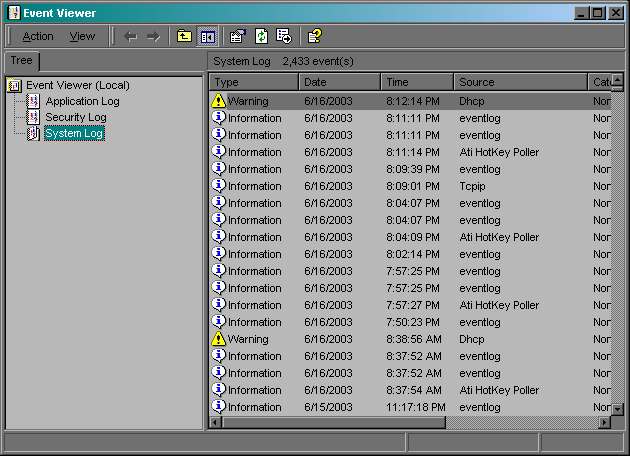

Ok, here is the latest (surely won't be the last) problem with my home network. Started all three computers yesteday and have no network connection. Cables, hub, network cards are all good. I cannot 'ping' any address of any type. The event viewer shows a 'DHCP' problem. See picture. My machines have used a static ip for about a year now. All three now have decided to use DHCP. This is a mutiny /forums/images/graemlins/confused.gif

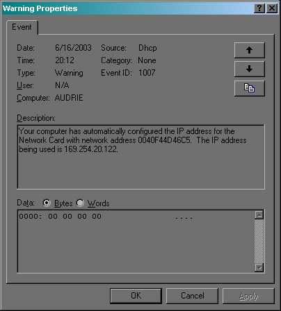

All three computers show the same error in the event viewer. The detail view shows that each has a different new DHCP address which is outside the range of known addresses. See picture. How can I turn DHCP off and return to my happy land of static IP ?

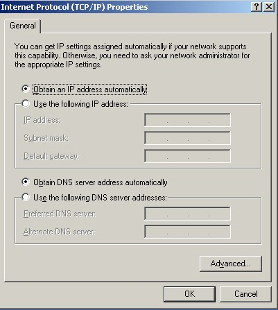

<font color="blue">How can I turn DHCP off </font>
Start, Control Panel, Network and DialUp Connections, Local Area Connection, Internet Protocol (TCP/IP), Properties.
Obtain An IP Automatically is selected.
Change it to
Use the following IP address
Each PC has to be on the same subnet, i.e.,
PC1 192.168.1.1
PC2 192.168.1.2
PC3 192.168.1.3
See attached.

Thanks Mike, Start, run, commands, ipconfig, shows the ip that is assigned to my ethernet card. It is the same address that is seen in my second picture. (not the goofy 'out-of-range' one) When I manually configure (per your instructions) the ip address to this setting it does not make any difference. I find it very strange that all three computers are displaying this problem. The network ran great for a year, now this strange event occured. I am wondering if an invasive code has entered my network. This code could be readdressing the IP in an attempt to use my computer(s) as a drone.
I have tried physically removing my network cards, rebooting, reinstalling the network cards, reinstalling the driver, verifying that I am using the right network names and groups. I cannot even 'ping' 127.0.0.1 on any of the three machines (IP loopback). Also, when I go to my network places, computers near me, the machines cannot find ""a list of servers"". Even with a bad router or cable, each machine should be able to see 'itself' on the network, but cannot.
Any thoughts on this?
