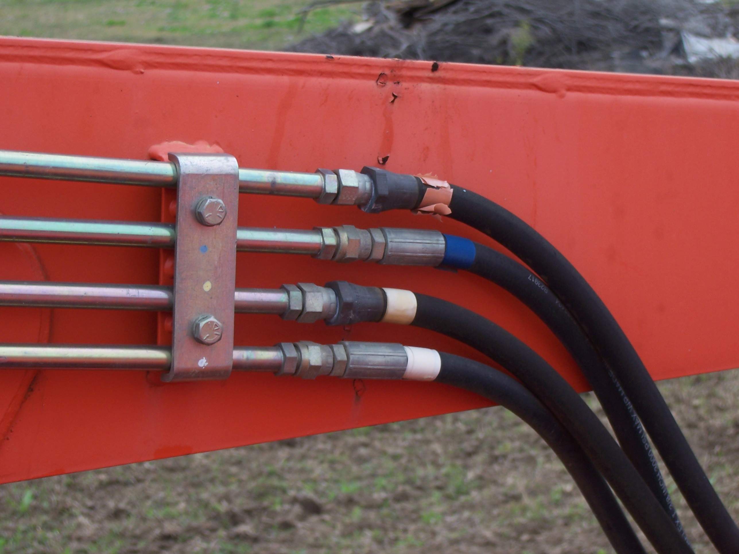

I am looking for a diagram for a front end loader. It is a model # LA1001 for a Kubota M4700.

He blew out two hoses that go out from the hydraulic control box & switched them around just to make it back home to lift the loader & he lost track of what order the hoses go in because several weeks went by before he made it to the parts store. He is just looking for a diagram for the hydraulic schematic. So, the hoses are basically out of order & he doesn't know what order to put them back in.

Ihave a m4800 ican take a pic and post it would that help
   / Diagram #10
I hope this helps

sorry dont know it gave u two of the same pictures let me try this

Thank you all so much...my husband figured it out today & he got it working properly. You've all been very helpful. :)
