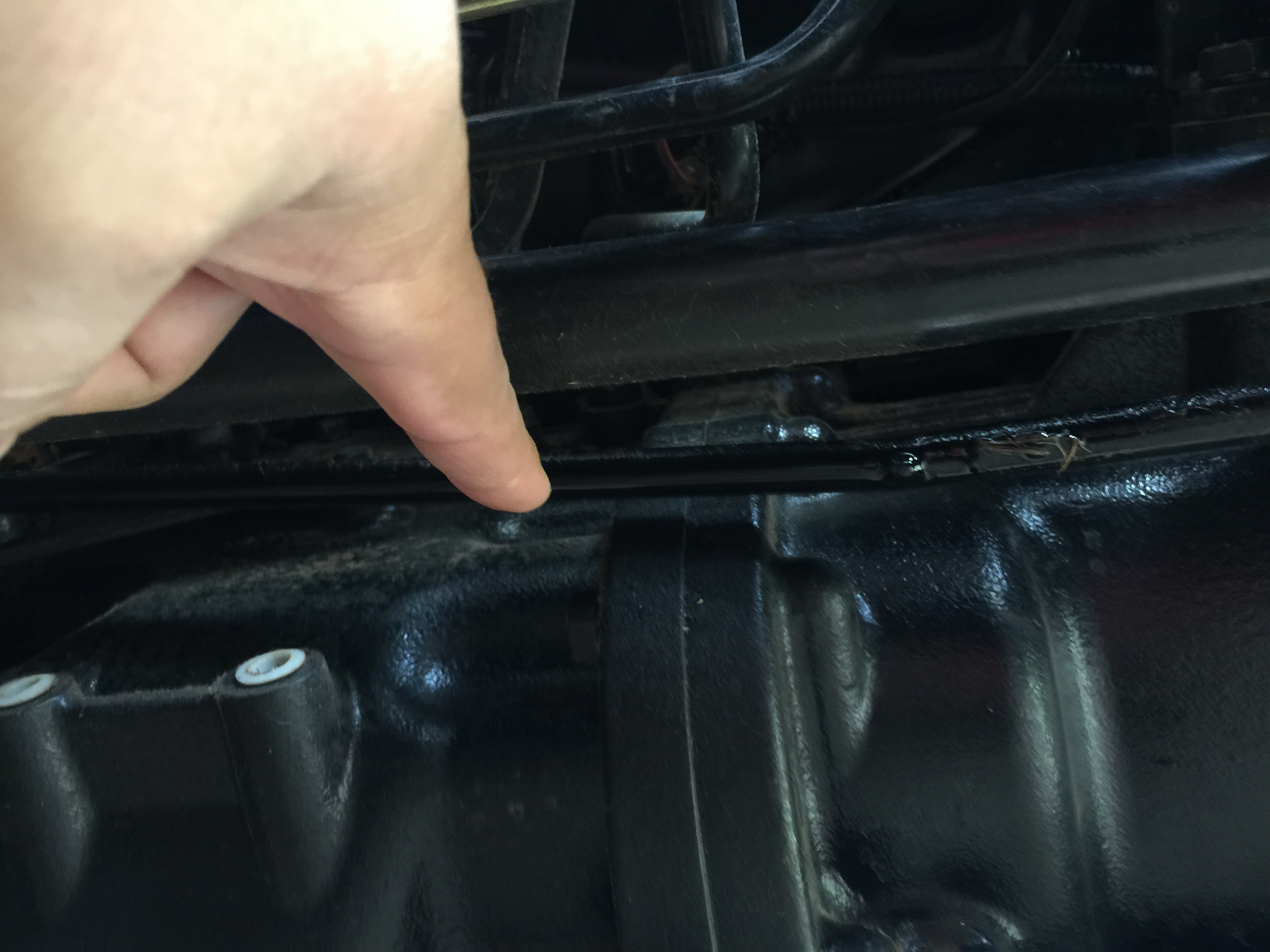

I just changed hydro. Oil at 100 hrs, the internal screen is a pain but I was able to remove 1 end (closest to filter) of that 1/4" brass colored rod with a turn buckle on it, it will just barely fit in
oh ok. did u need to loosen the bolts closer to the front?

hey Karl, did you change out the transmission screen next to the rear wheel? if so did u remove that bar?
I didn't - first I've heard of that. Sounds like dwalk19's got it covered, though. Is it something I need to do?
   / Did 2538 50 Hour Service - Now There's a Big Leak? #13
No that rod will come right off easily at either end, just bend the keeper pin straight and pull out and then remove pin going through bracket, I did have to loosen the lock nuts and take alittle tension off it to get it back in

Coyote, thanks for all the tips. They'll come in handy next time. I will make sure and check the hydro fluid after running next time I'm down there.
I didn't see a valve to stop the fuel flow to the secondary fuel filter. I've learned now that there are a number of tools made to clamp off fuel and other lines when needed. One looks like a pair of vice grips with rounded jaws that won't damage the hose. Harbor Freight has them for $15.
The leak was at the fitting I saw on Friday. It took a 22mm crowfoot, 12 inch extension, and a breaker bar to tighten it another 1/2 turn or so. No more leak! I'll try to remember to get a picture of it next weekend when I'm down there again.
I think I have the same leak. Please take a picture of the fitting & describe the location.
