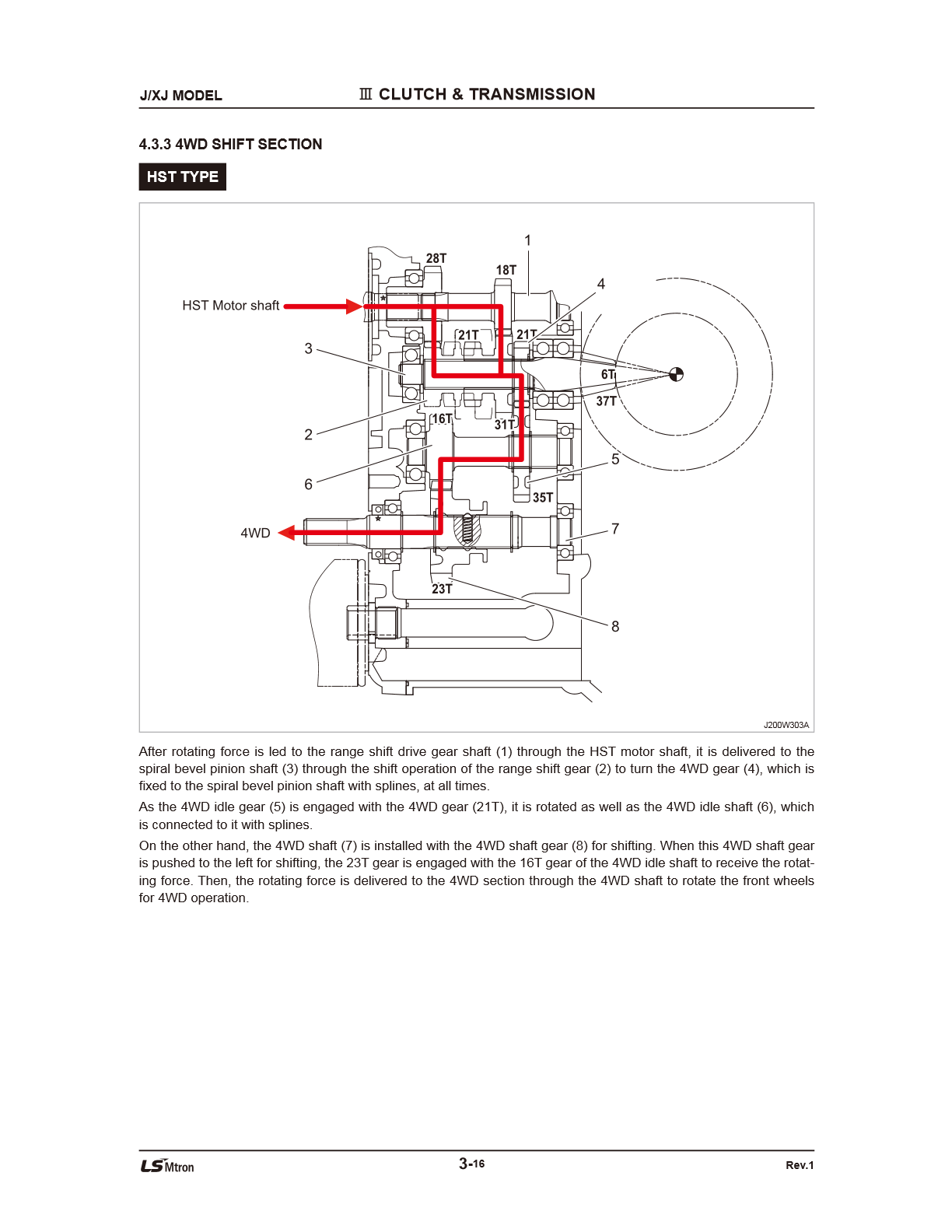

Fingers crossed for you Mr Rig! If you need a pic from the service manual, let me know and I will try and hunt it up. You have a dealer semi near you? loisfwd.png
