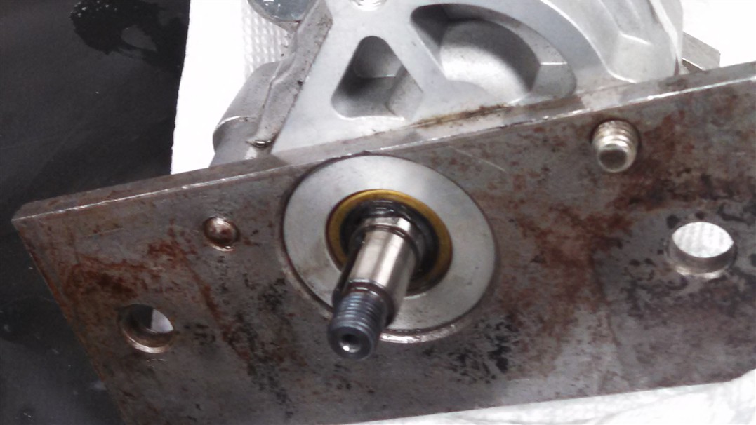

I have a 3 point lift on my 1949 Willy Jeep CJ3a. I have a history here of trying to get the hydraulics working. I finally purchased a new pump and the rest was working great. Took the jeep with a 400lb plow attached to a show last weekend. When I went to left the plow to load the jeep on my trailer, the lift was slow. Today, I thought I'd make sure the fluid level was good. This is a "closed" system - no breather. I took the plug out of the filler pipe and it showed fluid. So I started the jeep and lifted the plow. It went you fine and when I lower it, fluid shot out of the plug opening. So I stuck a 6" extension thinking that would help me "burp" the system. Fluid kept squirting out when I lowered (gravity down). After a few trips up/down, checked up the hood and fluid was flying from the front of the pump.
When I removed the pump, I could see that the seal is deformed. I can't be sure it wasn't leaking earlier. I have a spare seal from my days of trying to repair worn out pumps. Putting it in now and would like to make sure it doesn't happen again. So being a new pump, I guess it is possible that the seal was defective, but I'm more concerned something else isn't correct. Any ideas?

I'm wondering why you don't have a vent on the reservoir tank. The seal blew because it built up more pressure in the tank than the seal could withstand. I would put a vent on the tank and lower the oil level so oil doesn't blow out.

I wasn't able to find the required seal from the shop were I got the pump. They had me order the seal from Case/IH, but it is too big. The Case/IH parts guy found a close match, but it blew shortly after the hitch started to lift the plow. Before I started the jeep, I drained the fluid and installed 4 quarts of the IH fluid used with these pumps. I also put a 6" pipe extension in the fill tube, as a vent (didn't replace the plug in the fill tube).
At one point during the lift test, fluid came out of the vent pipe (~five inches above the top of the reservoir). I'm not sure if this was before or after the seal blew. If the system is now vented, there still seems to be excess pressure at some point (enough to raise the fluid five inches in the vent tube).
I'm at a loss as to next steps (other than to find a correct seal). Any suggestions appreciated.
