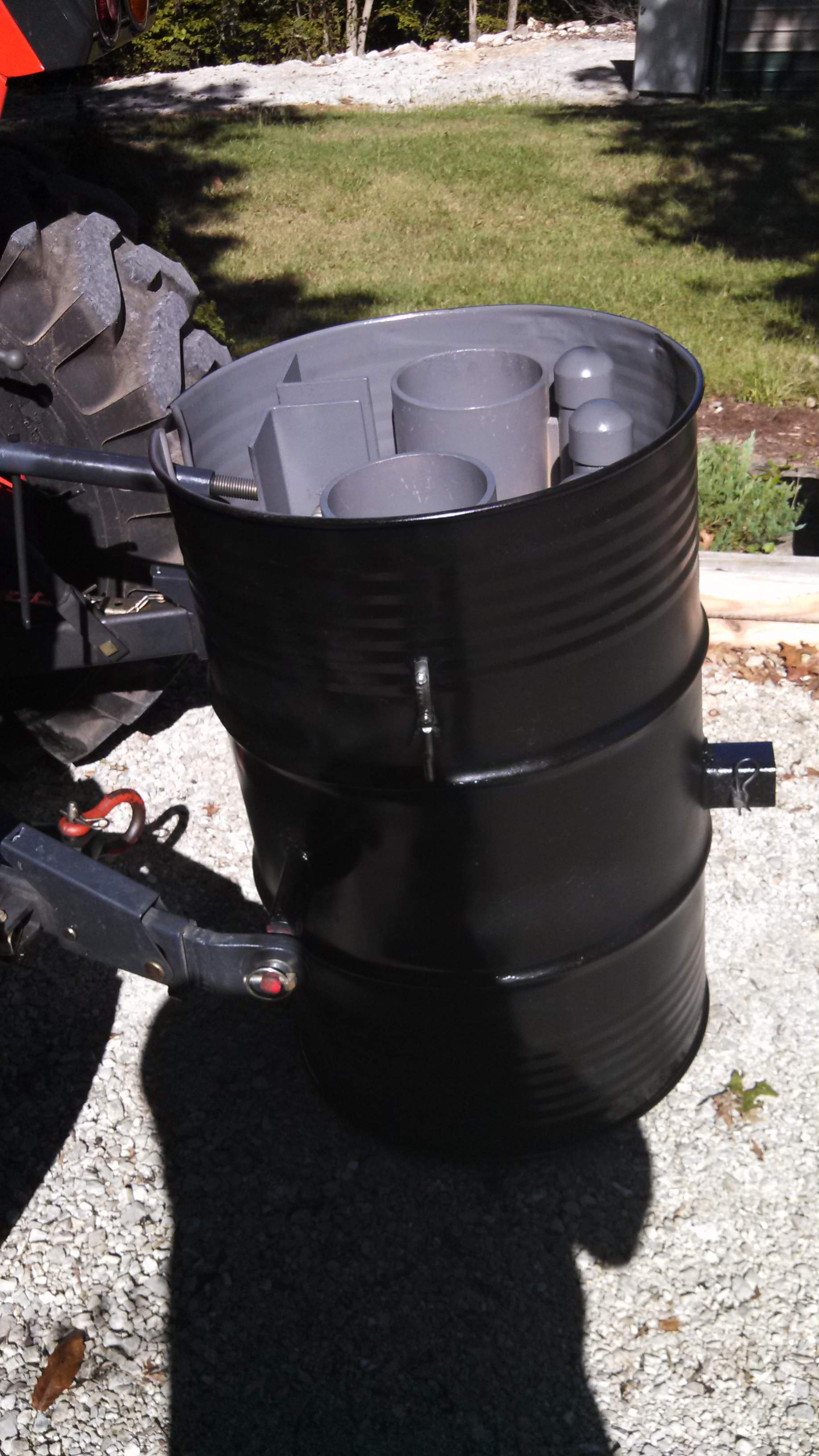

I just ran across the pics that I save on my computer..Can't remember where I got them..ballast look pretty good.

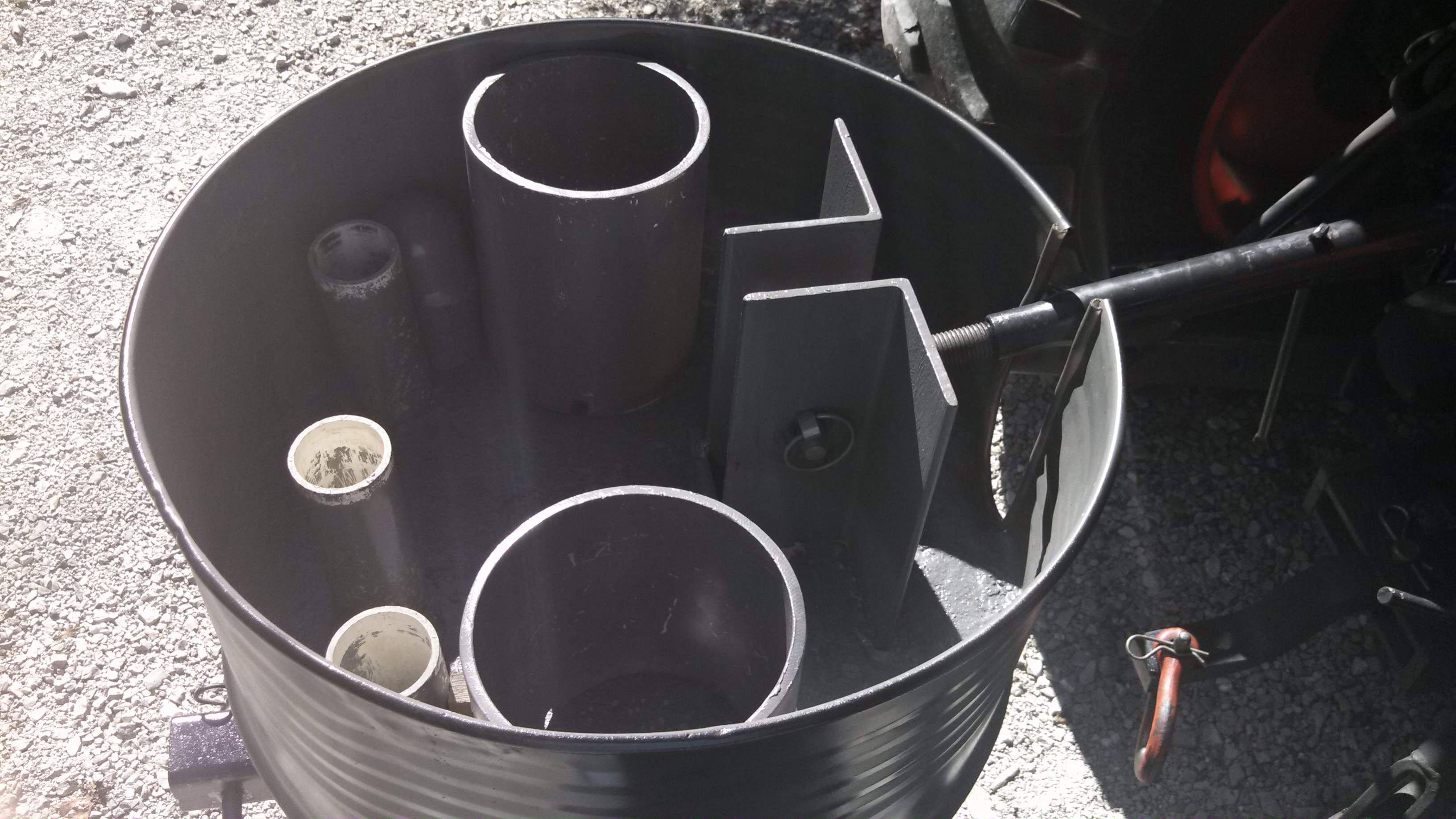

   / Did someone on here make this ballast box? #7
Not sure if your interested but a neighbor took a 55gal drum cut like a 1/3 or how ever much concrete you want and cut two holes in it to fit a old drawbar with category 1 pins in it and filled it with concrete over the drawbar works real well. I'm thinking about making one I just got a 6 ft tiller I can use for weight but that's ok till you get busy with FEL work and back up and bump something bad on tiller and what ever you hit the 55 gallon drums around here are common items to find for like 10 to 15 dollars I have no idea what a draw bar cost ok just a thought! The one in the pic looks good !
   / Did someone on here make this ballast box? #8
here is mine with the 55 gal drum and the drawbar thru it. (drawbar was $26). a few bucks for the cement mix.
