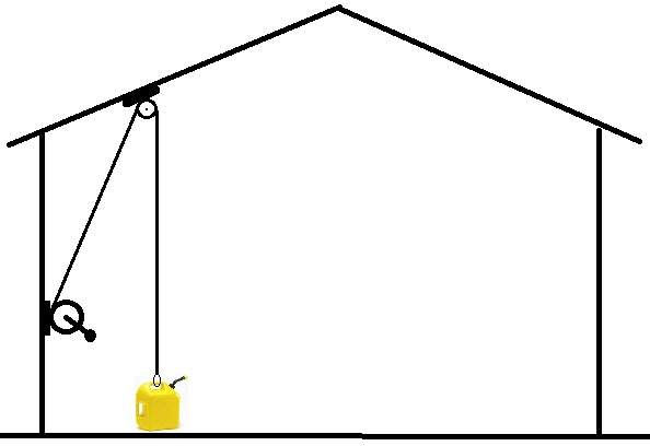

   / Diesel fuel storage tank #8
How about a boat winch mounted to the wall, a pulley mounted to the ceiling, & a cable to lift the can. Let that hold the can's weight at the right level while you directed it to pour:
attachment.php
