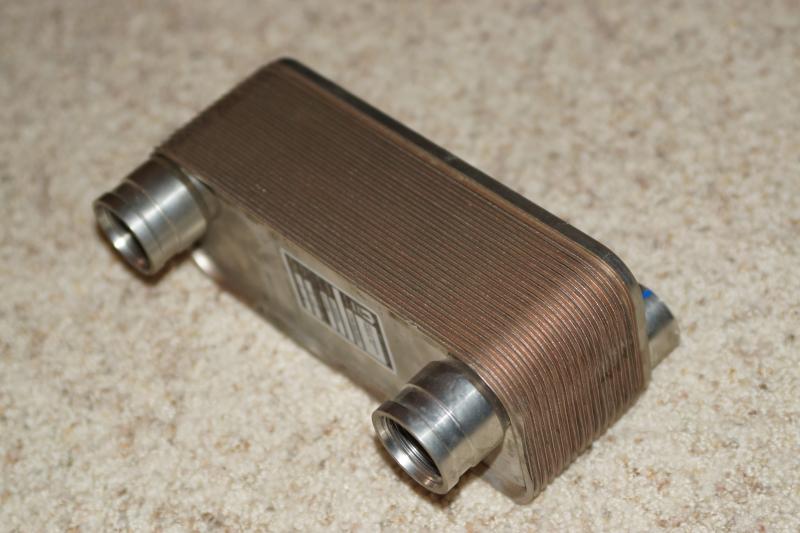

I got some oil to water heat exchangers in an auction and am wondering if I should use one to preheat my tractor's fuel?
I've read a bunch of reports of mixed opinions on the matter: from it being a power enhancer and increasing fuel economy to being harder on the injection pump - so which is it?
The benefits would be less chance of wax clogging the filter when running in the winter and possibly better atomization. Downside is obviously more complexity in the cooling and fuel lines, greater chances of leaks, harder to purge when run dry, and I don't know if a 100 degree temp rise is really that hard on an injection pump but I'm no where near competent enough on the subject to make that call.
So what do you guys think?
The exchangers are stainless brazed with copper and have heavy duty fittings (the reason I bid on the lot was all the silicon hoses and belleville washered hose clamps, and stainless hydraulic elbows, etc) and are probably 6x3x10" or so which means it's not that big or hard to stash somewhere. I don't have any pics or I'd post one up to show you.
I also have some bigger exhangers as well, but those would be difficult to integrate and probably way too big for the task. The coolant lines on those are 2" in/out.
My tractor has a stanadyne db4 mechanical injection pump if that matters.
Thoughts?

I'll get a pic later and post both styles of the exchangers I have.

I was wrong about the size of the smaller exchangers. These are pretty close to the dimensions of a 4x4 and only 9" long.
You're right: adding a little pump would circulate the system. I wonder how much heat would be lost in the non-heated sections (nothing to lose but try it out). The coolant heater I have cycles between 100F on the low side and 120F on the high side, so not super hot.
