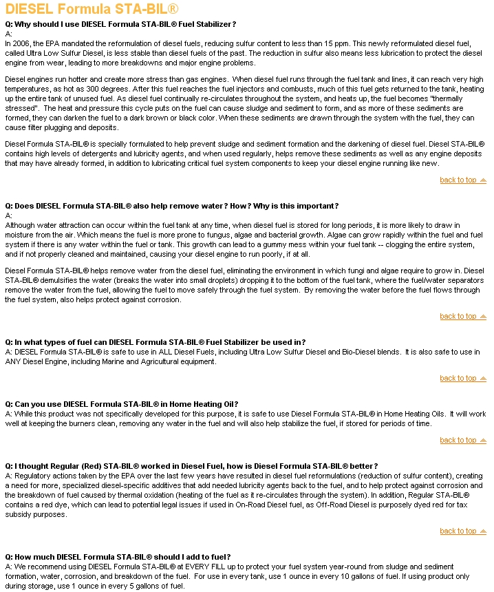

   / diesel stabilizer? #8
A while ago someone here explained that diesel StaBil and PRI-D work to stabilize fuel by blocking "free radical chemical reactions". Basically they are antioxidants. This is quite the opposite from cetane boosters like Power Service, which help initiate free radical reactions.
I'm not saying Power Service is bad stuff, but don't add it if the fuel will sit around a while. Wait until you are going to use it before you add Power Service. For fuel storage use StaBil or PRI-D and perhaps a biocide.
