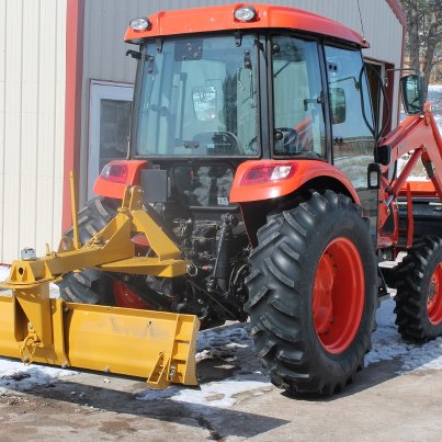

I'm about to buy a 75" or 84" (my Kioti has a width of 66 inches) rear snow blower and I'm trying to decide between the above blowers. Each has 4 paddles, good size auger depth and diameter. I anticipate the Landpride is going to be slightly more expensive than the other two models and just want to make sure the unit I buy works and works well for a long time perhaps even after I retire my Kioti for another tractor down the road.
I'm still very much a nubie in owning and operating my tractor so I appreciate any thoughts, advice and information people can provide.

I'd imagine it would be hard to go wrong with any of the above choices, as none of them are cheap, Chinese junk. Both Farm King and MK Martin are made in Canada, where they know a thing or two about winter.:cold: Land Pride has a very good reputation for quality products as well, as they're made in the good ol' US of A.:thumbsup: One thing to look for is adjustable/replaceable skids. I Love my Buhler/Farm King and imagine it will outlast me.

I run a 84" buhler farm king last winter with zero issues, it is a high quality unit and I would not hesitate to buy another one just like it.

The important thing to look at on the blower is the clearance between the tips of the blower vanes and the housing. The smaller the better, I used to have a 60" AgroTrend which was great. I think the clearance on that was less than 1/8". I replace it with a used 78" Lucknow, what a heavy built beast! Those Canadians sure can build blowers! In my area the Meteor and AgroTrend are the big sellers and I have never heard any problems with either.

Generally speaking, all the rear mount snowblowers spin at 540 rpms since there is not a ratio change in the gearbox. Because of this the models of snowblowers with a larger fan are going to throw the snow the furthest (assuming all other things being equal). There is a lot a talk, rightly so, about the clearance between the fan tips and the housing, but not that much chit chat about tip speed. An example of this is that the fan on my front mount snowblower on my garden tractor spins at a little over 900 rpms but throws snow no further than the snowblower on my tractor that spins 540. I am guessing that my walk behind snowblower, with its small fan, has to spin over 1000 rpms to throw snow an equal distance as the other two blowers.
