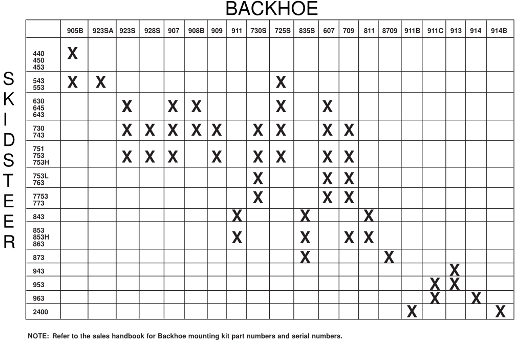

Can anyone tell me the differences between the Bobcat backhoe models available around the late 80's that may fit my 1988 843? I believe the models are 905B, 907, T906, 909, 911 and 913? Which ones fit my machine? What are the differences? Thanks.
   / Differences in Backhoe Attachments for Bobcat 843 #2
The 905B is a small backhoe made for the 400 and 500 series loaders so much too small for your 843. The 907 and 909 are for the 700 series and might work on the 843. The 911 is the backhoe designed for the 843 while the 913 is a monster for the 900 series machines. I don’t know about the T906 so can’t help you there...
   / Differences in Backhoe Attachments for Bobcat 843 #3
T906 is for a ancient obsolete trencher.dont have outriggers
