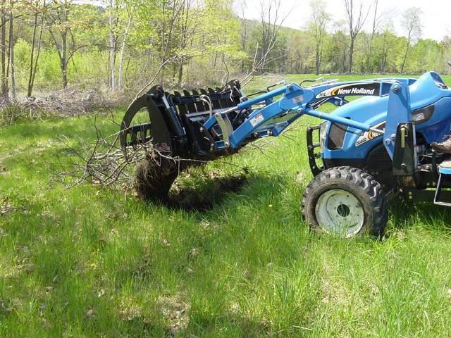

Here's a pic

Thanks for the help Hazmat. The Anbo is one I'm looking at for my TC40. What width did you go with?

I'm pretty sure it is the 66" Light duty model. 66" was big enough to cover the tracks, but we figured smaller was better to avoid "racking" the loader arms. There is a much better chance of un-evenly loading a grapple than the bucket.
Anbo recommended the light duty version so as not to decrease the lifting capacity. I think their heavy duty models are for larger skid steers (with much higher lift capacities). Doesn't really "look" to be light duty - I think the difference is the thickness of the tines.
