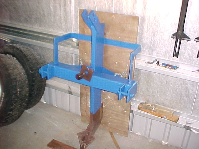

   / Digging a trench #7
I use a single tyne ripper with a pipe layer attachment on the back.
I rip the trench twice, then go back with the pipe layer attached and it lays the pipe in the trench. Doesn't go real deep, but deep enough for water & irrigation.
Picture attached without the pipe layer attachment.

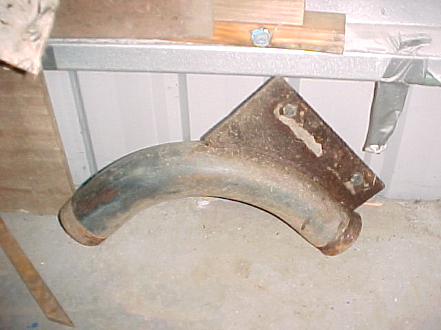

   / Digging a trench #9
Neil,
Could you please post a close-up of the pipe laying attachment? I have a ripper and have been wondering about using it to lay water lines. How big a line can you bury and what length?
Thanks,
Donald
   / Digging a trench #10
Donald
Attached is the pipe layer. It is home made (not by me) and is just a large sweep bend of galvanised iron pipe. It bolts on to the back of the ripper as per the next photo.
I have laid 25mm water pipe and apparently it can lay up to 40mm poly (1.5"). If the pipe was really flexible, I suspect you could lay almost as big as the pipe layer's bore size.
Any length can be laid, just lay a bit past the joint and back up and start the next bit. Join later by hand. Doesn't go real deep but might just be my soil.
Hope this helps.
Cheers
<font color=blue>Neil from OZ.</font color=blue>
