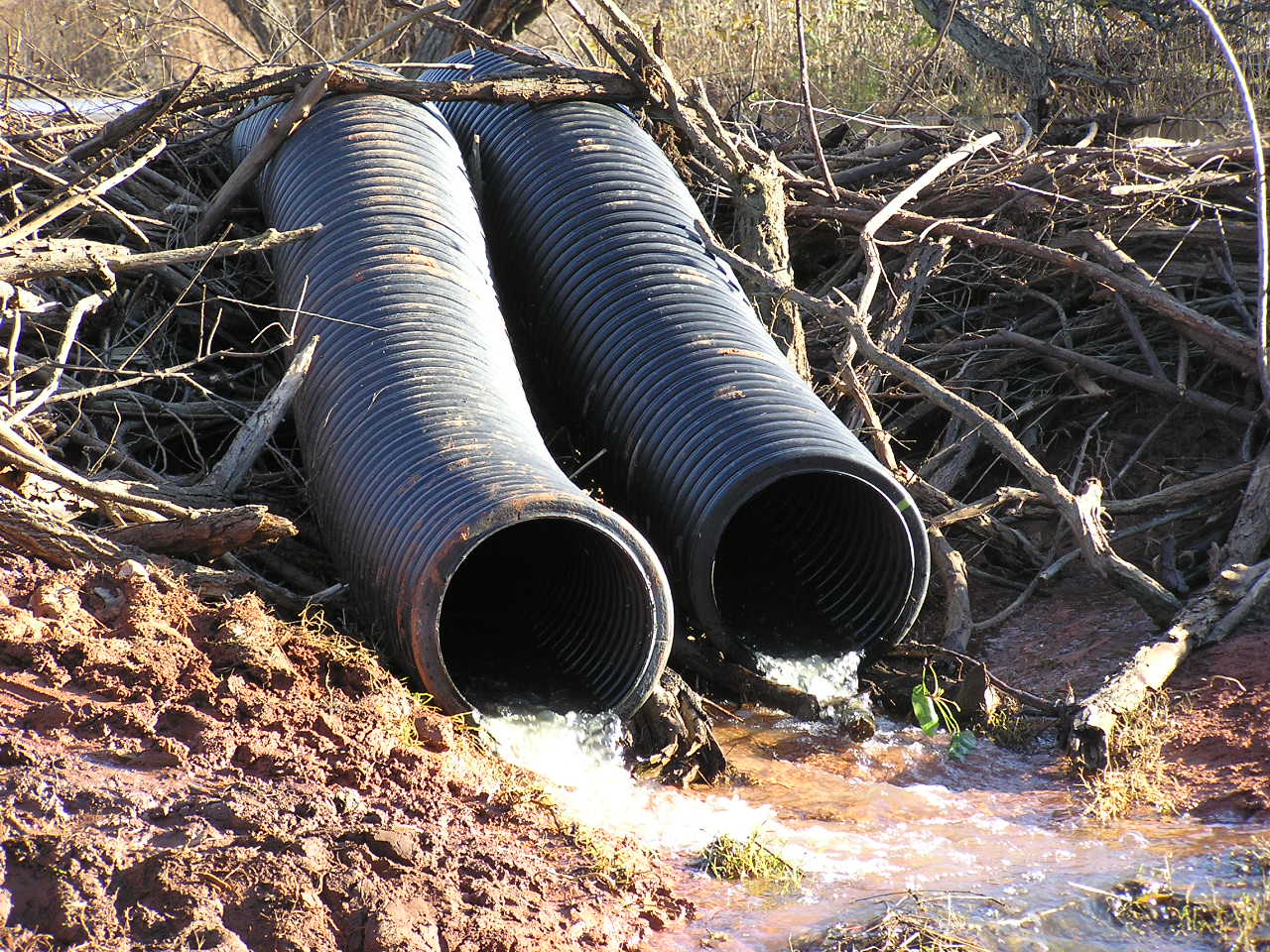

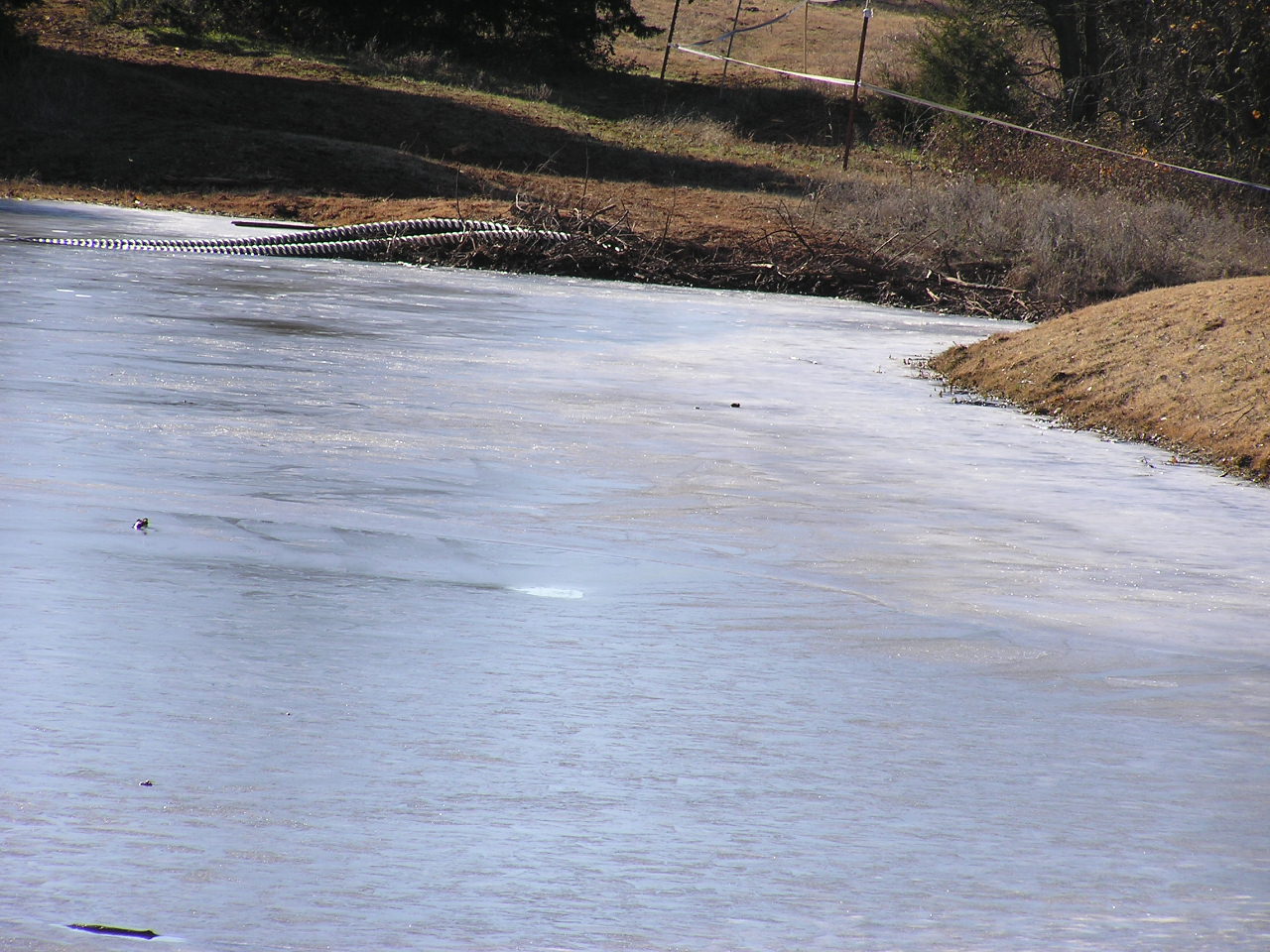

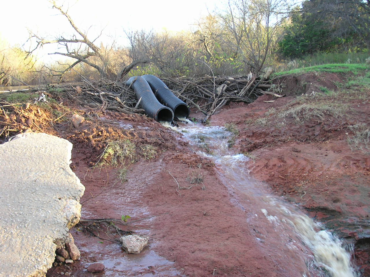

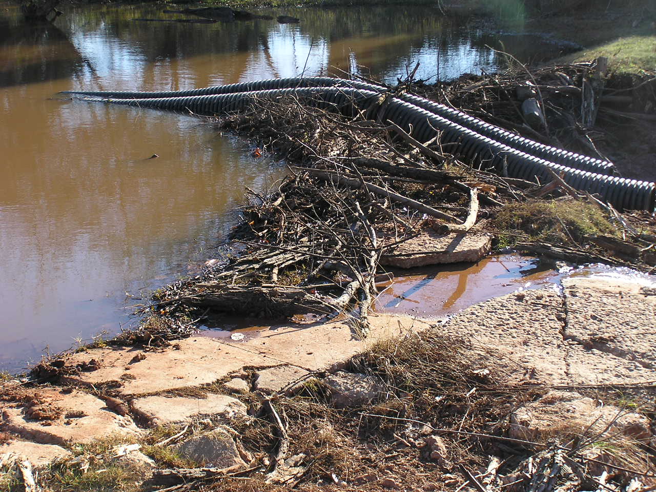

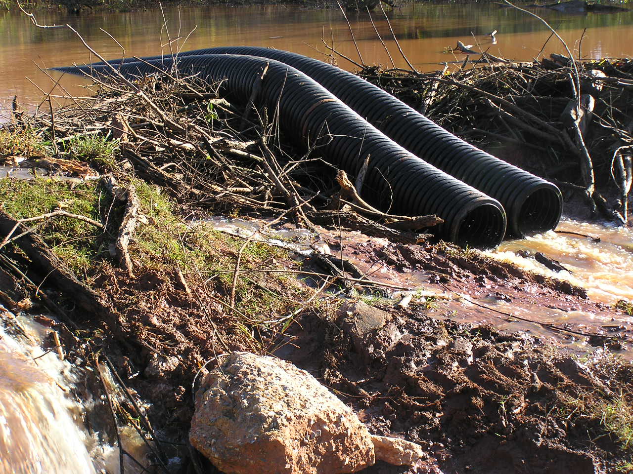

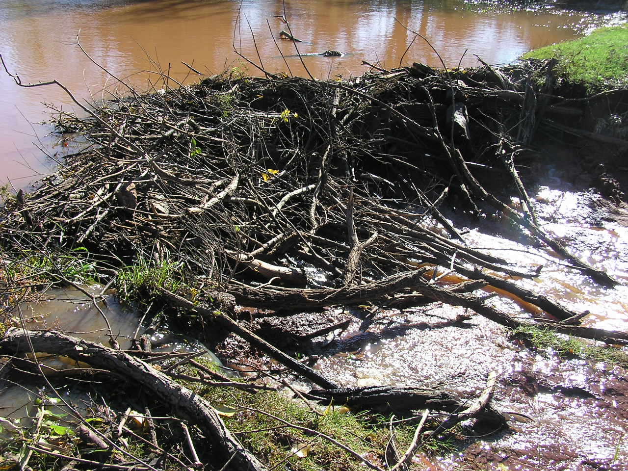

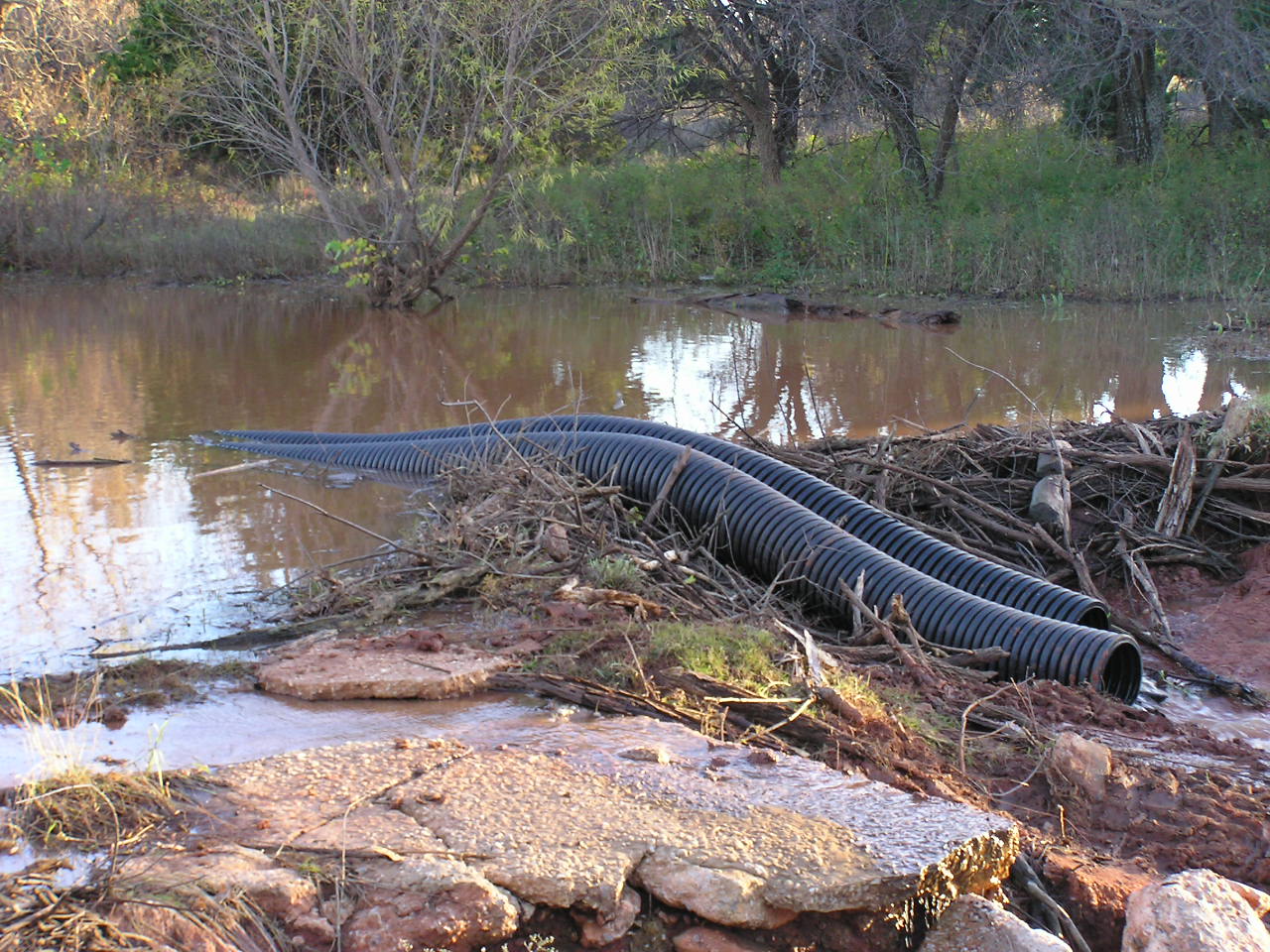

From November 2004, beavers dammed the pond spillway. I had some flexible drain pipe, so I fastened them together, and a weight on one end and put them over the beaver dam.
Two days later, as long as the weighted ends were under water, it would siphon.
A week later, they have added more sticks, but water is still siphoning. :thumbsup:
A little ice on the pond at the end of December, but water is still flowing. The beavers gave up and moved on, some time after this picture was taken.
