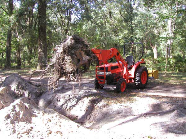

Here is a 40 inch oak stump removed with a Kubota L-3130 and LA723 FEL with 72" square bucket. I just dug down through the roots until I hit the rootball on two opposite sides and then dug around the other two sides through the roots. Then lifted it up and out with the FEL.
It is a pretty good amount of work that is easier done with a BH, but if all you have is the JD & FEL you'll be okay as long as you do not run into too much rock or clay.... /forums/images/graemlins/wink.gif
